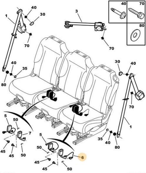

Rear seat giving audible warning even when seat belt is fastened. Quite annoying when child sleeps and after small bump on the road it goes off. Even restarting the car often not helping... Was hoping that cutting some wires may sort that....

Cutting wires is not the solution or you will find the whole system will likely fault. You need to get it to the dealer and get it fixed. It will likely only be a seatbelt sensor, or the wire to the seatbelt buckle unit that has been disturbed.

Now trying to find them stalks... ranging online anything from 20-70€. Any advice and or part numbers to look for? 2009 Grand Picasso 7 seater. Will need 2 or all 3 for 2nd row.

If you suspect the buckle, the units are identified from the diagram below for the intermediate row of seats:
I believe the sensor wiring is integral to the buckle unit. But I'd also check the connectors shown below on the units to where they connect to the harness in case the fault is not in the buckle but in the wiring from there on. I believe that item (7) is the intermediate buckle.
(5) Right, Part: 8774YA, £91.96
(6) Left, Part: 8974YC, £91.96
(7) 8974YE: 8974YE, £91.96
Direct from Citroen, inc, UK VAT.
