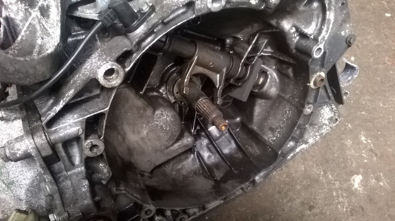

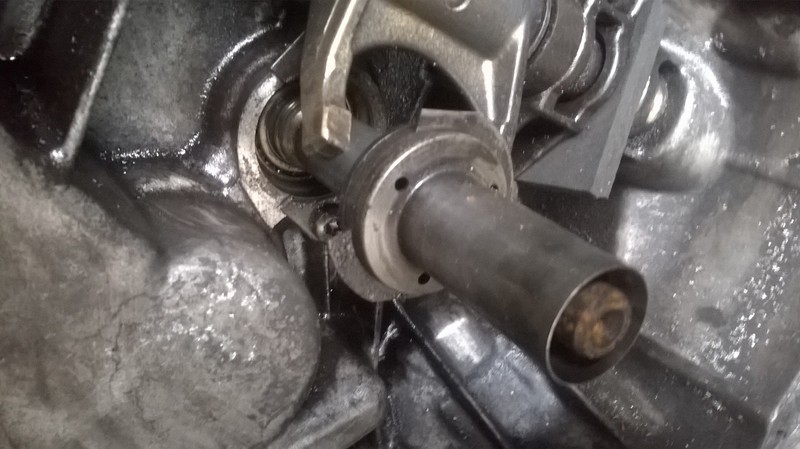

ken newbold
- Posts: 251
- Joined: 18 Mar 2008, 16:56
- x 4
Re: Synergie clutch fork, part number confusion? (also crankshaft oil seal question)
Is this like yours?
this pic showing the damaged guide tube with oil seal, make sure you get a new one as they do break

Ianhw77k
- Posts: 123
- Joined: 01 Apr 2014, 19:38
Mine isn't quite like that one, different fork and shaft set up. The tube looks OK on mine but I'll see if I can get a replacement.

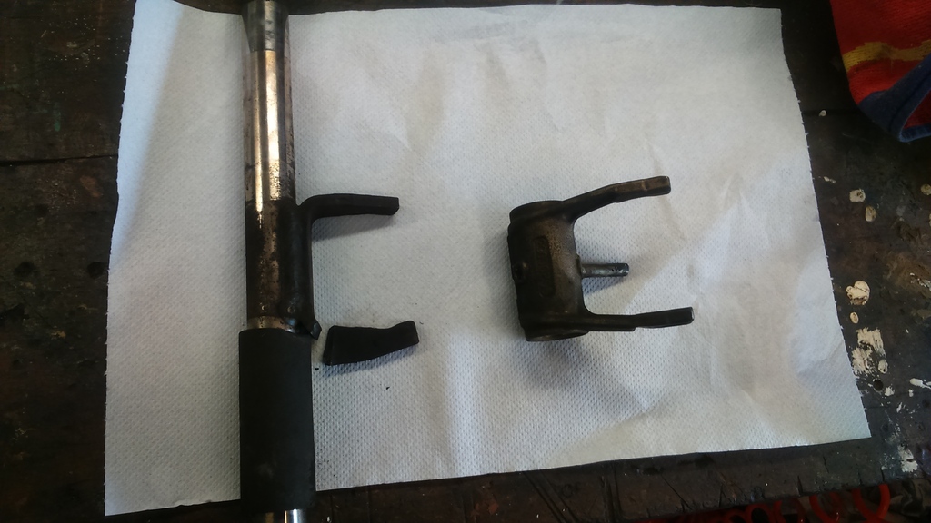

Ianhw77k
- Posts: 123
Here's my broken clutch fork, alongside the wrong part that literally just turned up!
Where can I go from here?
1995 Citroen Synergie 1.9TD (Mine)
2001 Citroen Xsara Picasso 2.0HDI (The wife's)
- x 6950
Short of waiting for a part to become available or some extensive scrappy searches - is it worth talking to a professional welder to see if they can repair it?Ianhw77k wrote:Here's my broken clutch fork, alongside the wrong part that literally just turned up!
