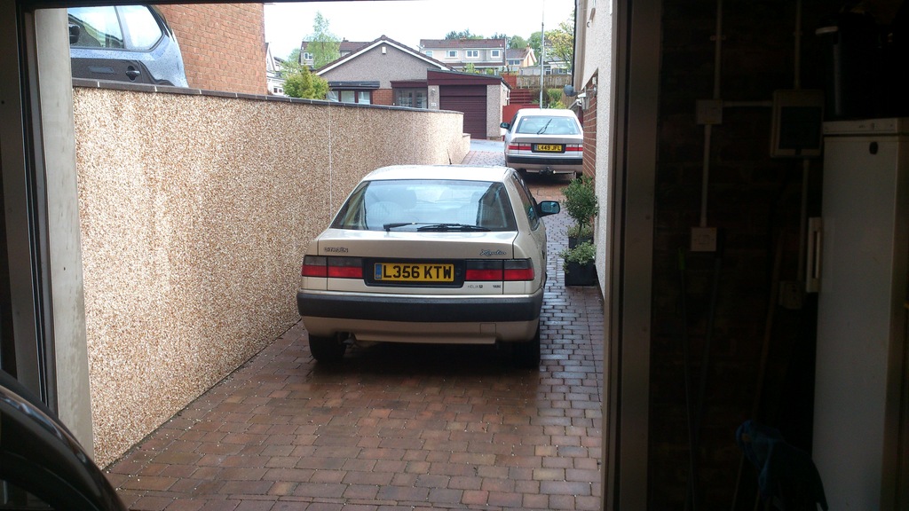

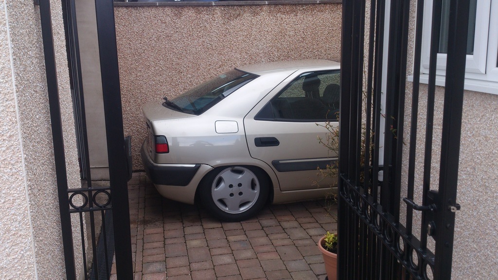

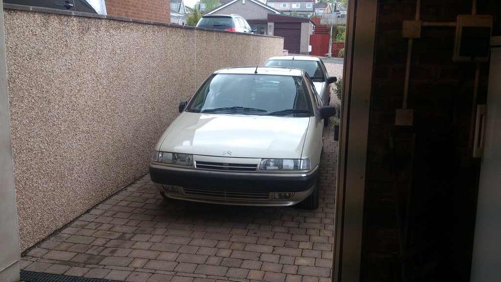

Pics!
It's a sinker! it has sinked :D

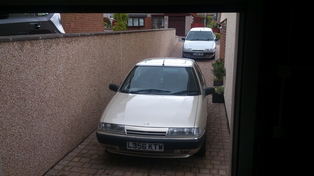

Two sinkers - living the dream!!

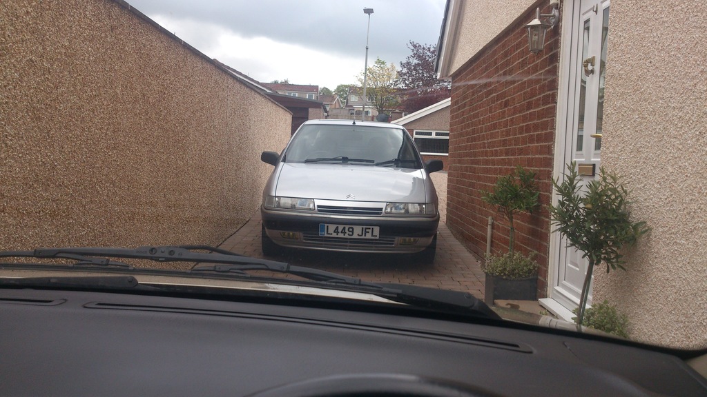

The silver hornet from the new sinker

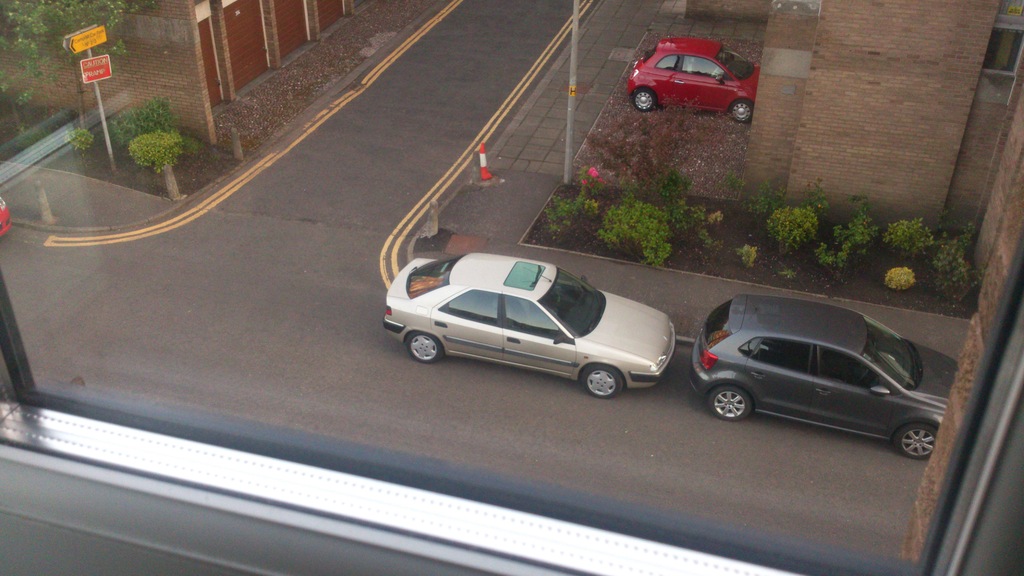

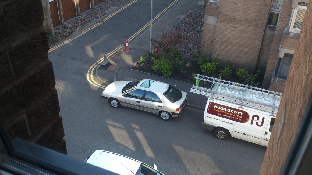

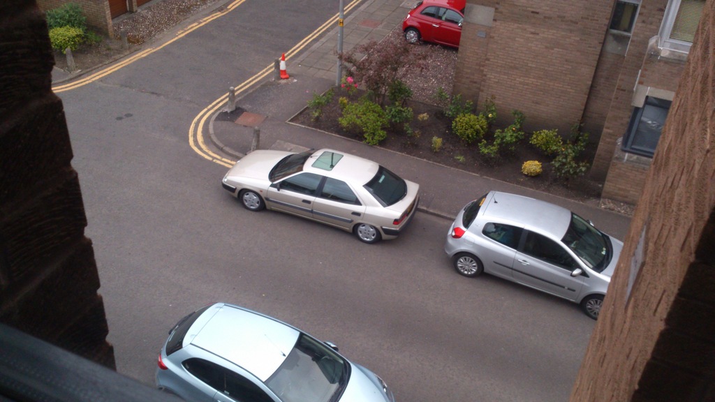

Crappy 'view from the flat' shot - but couldn't resist after I managed to get a parking spot in view of the window (rare..)

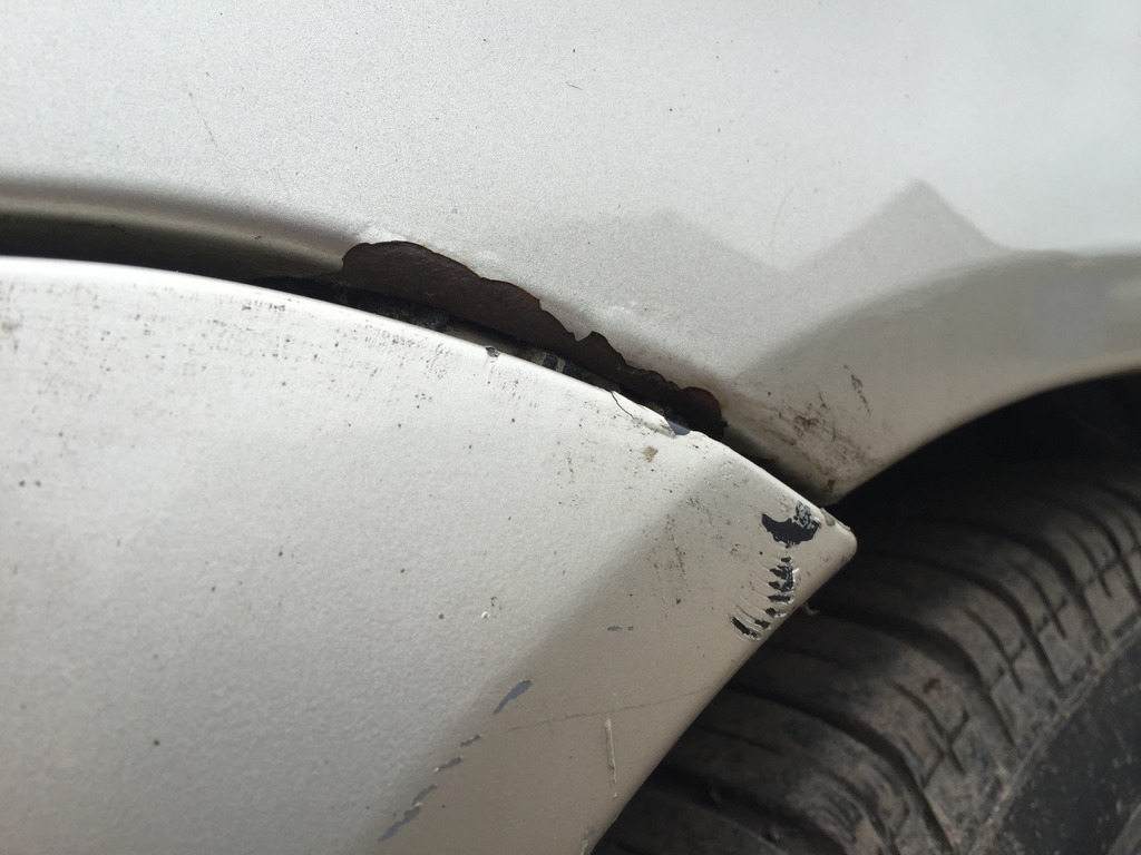

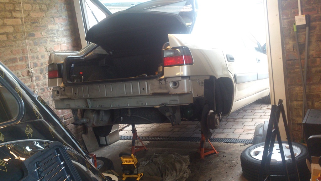

Some preventative maintenance - solving the potential rot spots of the Xantia..
To fix this little rot spot

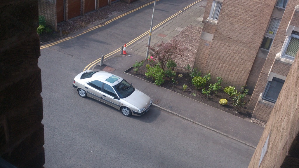

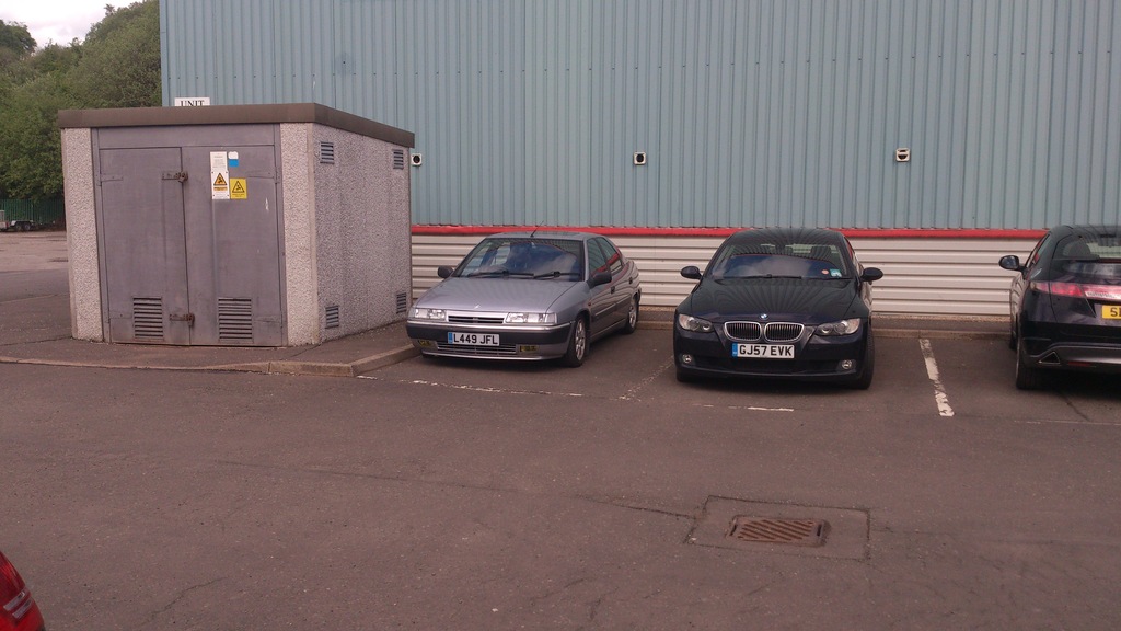

And just incase gold isn't your thing here's the silver hornet again!
I'm going to miss the hornet but the gold Xantia replaces it. It goes well but the miles are getting a bit ripe and the clutch is starting to judder and slip with the turbo kicking in. Best to store it until the MOT is out in September and then I think it's to be broken for the useful spares (ABS sensors, HP pump etc..)
