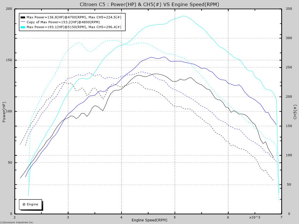

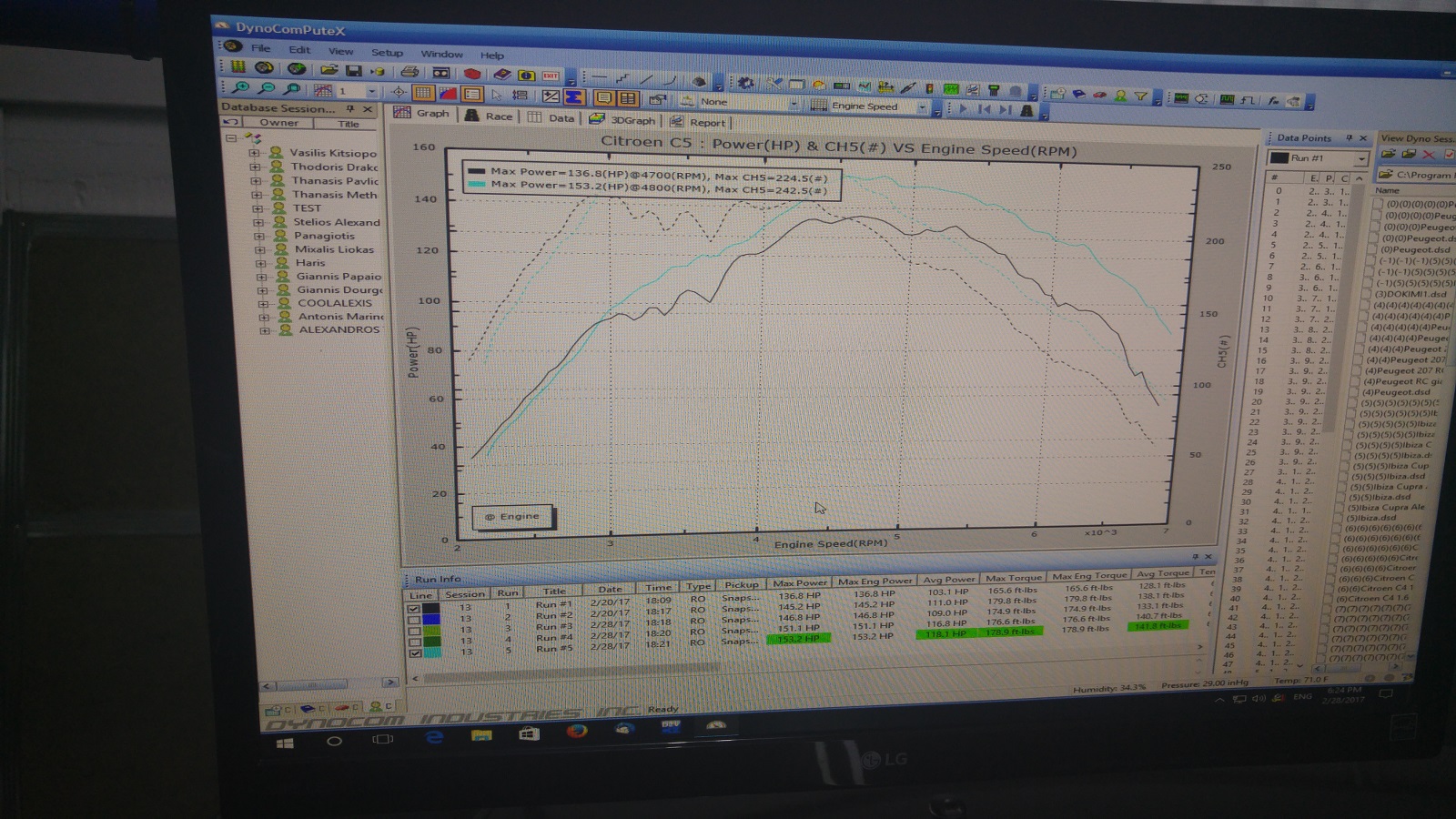

So I've noticed that my C5 was particularly slow the last couple of months, and feared that something was wrong with the engine. So I decided to go for a dyno session to the tuners that had remapped my C5 last year, just to see what's going on. Apart from realizing that the dealer had installed the latest version of the stock maps (so I was back to the stock 156HP), we noticed terrible timing, reduced maximum HP and torque, and horrendous top-end losses. Since all the tell-tale signs of carbon build-up were there, I decided to do a decent soda blasting cleaning and then come back to re-dyno the car.
Just by cleaning the intake track and valves, and a new set of plugs (although the old ones didn't have any seriously obvious wear), maximum power jumped from 135 to 153HP, maximum torque from 22Kgm to 24,5Kgm, but its the top-end that seriously benefited from the cleaning, since the engine picked up almost 30HP at 6000rpm, and the increase of 2,5Kgm of torque is almost 4Kgm at the same rpm !!!!
So after taking care of the carbon build-up problem, we proceeded with the new remap (we had to take the ECU to the bench to decrypt the new stock maps), with the same goals as before. And after 3 reflashes and about 5 or 6 dyno runs, we ended up with 195HP and 30Kgm of torque. Car feels decently quick now, has more pull throughout the rpm range, continues to push hard even in the reds, and even has difficulty putting down all its power in 1st and 2nd!

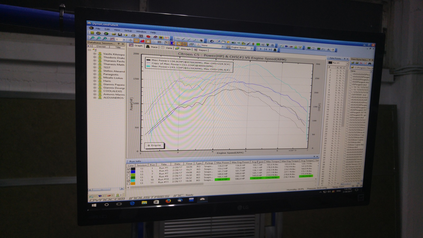

And a proper dyno plot, with lines for before-after valve cleaning, and for the Stage1+ remap.
