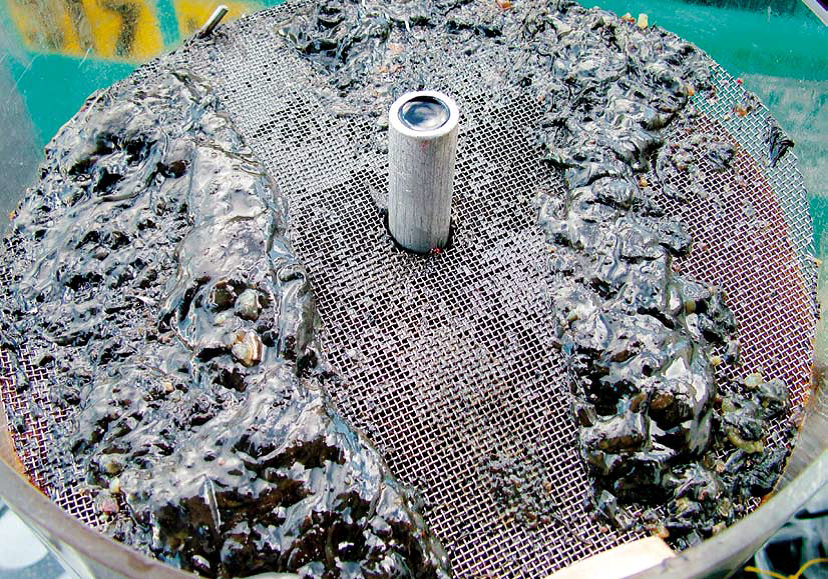

But as Simon says, the filter and HP pump come first. As there is a hand pump there will be no lift pump in the tank but there may well be a filter there, possibly just a strainer, but a lot of crud can accumulate there especially a biological mass caused by bacteria that feed on the diesel.
This is generally worse when tanks are only partially filled and there is a lot of moist air in there that promotes the growth of said bacteria.
There are photos on the net of it and it isn't pretty or healthy for the fuel system.
Diesel bug
I was looking for some and they were around half that price.
In the end I had them cleaned and one of them refurbished for about £180. No more problems with them since.
Someone at the Wetherby rally that year (was years ago now) offered to source some new ones for far less than the retail price but I didn't follow up on that and unfortunately can't remember who it was, possibly KennyW. The going price on eBay then was about £160 each.
Diesel bug
