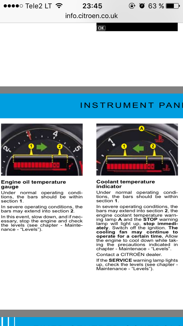

To be more precise, the bars dont appear to be on the same level (coolant and oil) as shown in the picture:
The coolant temp seems to be lower than the engine oil temp
I apologise if this is a stupid question to you, I'm not a specialist in this field

Nor are Citroen :)

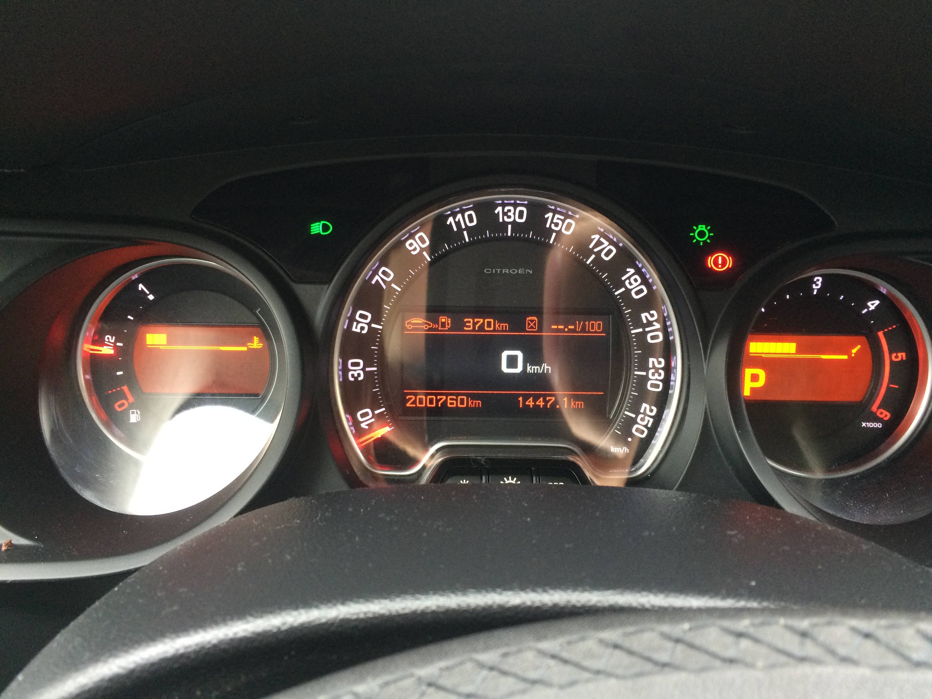

So guys today while driving in the morning I was observing the coolant temp (left) and engine oil temp (right). After driving for 30mins after cold startup at 3 degrees of
Celsius in the morning I got:
While driving I noticed how the coolant temp (left) increased to 3 bars, stayed for a while and decreased to 2 bars. After some time it increased again to 3.
So I'm really curious about this so Any thoughts are very welcomed and appreciated.

The first thought is that the bars don't actually indicate temperature, they indicate the data that the ECU sends to be displayed. There is no direct connection between the temperature sensors and the gauges, The ECU interprets the data and decides how many bars should be showing and so ultimately depends on what it has been programmed to do.
But, if we accept that the bars actually represent something real, then it's more-or-less as I would accept. The engine heats the oil up first as it's in closer contact with engine and then the water follows. The 2bars - 3 bars - 2bars movement could be an indication that the engine has heated up to the point where the thermostat (Do the engines have a thermostat? Is there now a valve that is under control of the ECU?) has opened and that has reduced the temperature back a slightly lower running temperature.

This actually may be the case, not sure if the 1st or 2nd one, but still. Since I haven't noticed any changes in the drive itself. Everything seems as good as before. It's just I was being aware of some early signs of malfunction, but hopefully it is not. :)
Thank you for your detailed post mate!

@ ohyes - What you've posted in your picture is perfectly fine ... only after a longer drive will the left indicator come close to the right side one's value
x 1746
Re: Coolant temp vs Oil temp
Those visual displays have no units. As such, they are just a graphical representation of normal and abnormal operating conditions. You might as well have a traffic-light system. Can't go bothering today's average driver with figures, can we?!
