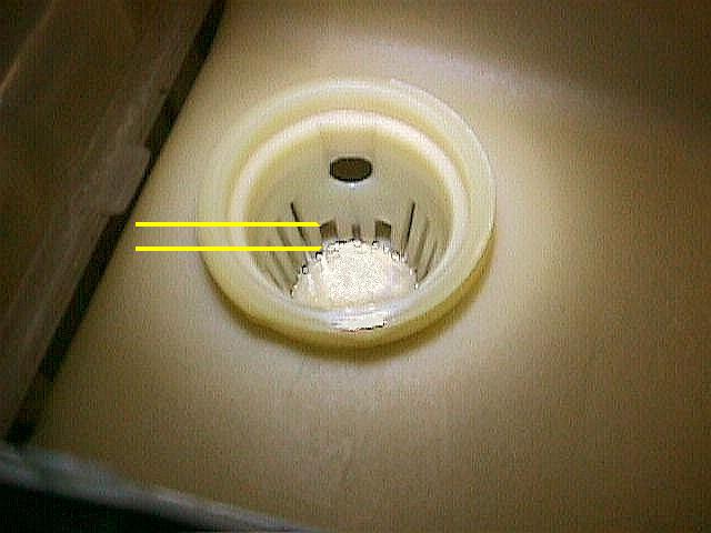

Cheers. At the minute the plan was to make sure its actually lds thats in it and not lhm . The tank is the black one. I assume whenyou open the cap the recess with the slits all around it should fill with fluid to show level on low? It seems to be dry so im guessing it needz a top up at least

Yes, fill to the bottom of the cup at low level.

You will need to depressurize the system to check the level. If you simply lower the suspension it will look empty when in fact it's not.
