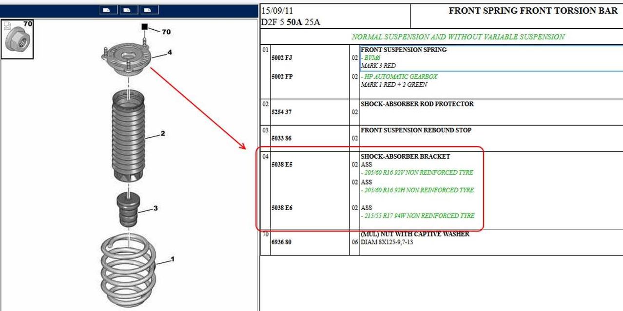

I need to change the front shocks on my 407 2.0 hdi 135 and while Im at it I want to change the strut top mounts/bearings, looking at various web sites it appears there are two rim sizes 16mm or 17mm now being a newbie to Peugeot and this site is there a way of measuring to find out which I have before dismantling the car.I like to get all the parts ready before I start. thanks

Welcome.
PSA Servicebox should ( ! ) show the correct one to use if you supply it with your VIN and vehicle specifics.
http://public.servicebox.peugeot.com/pages/index.jsp Although its paid, the parts lookup is mostly free I'm sure.
Tip: Change language to English first as it can jump around a bit sometimes.
I had a quick look, I chose 4 door saloon, engine type 2.0 Hdi 138 (there is quite an engine choice) , it did list two (I chose standard not variable suspension) for this however the difference appears to be based on wheel size:
Item 4. It seems its based on if you have 16 or 17 inch wheels...
I'm hoping this is a little bit of help for the moment.

excellent thank you very much indeed I do have the 17" wheels so with your help I have identified the correct part.thank you again.
