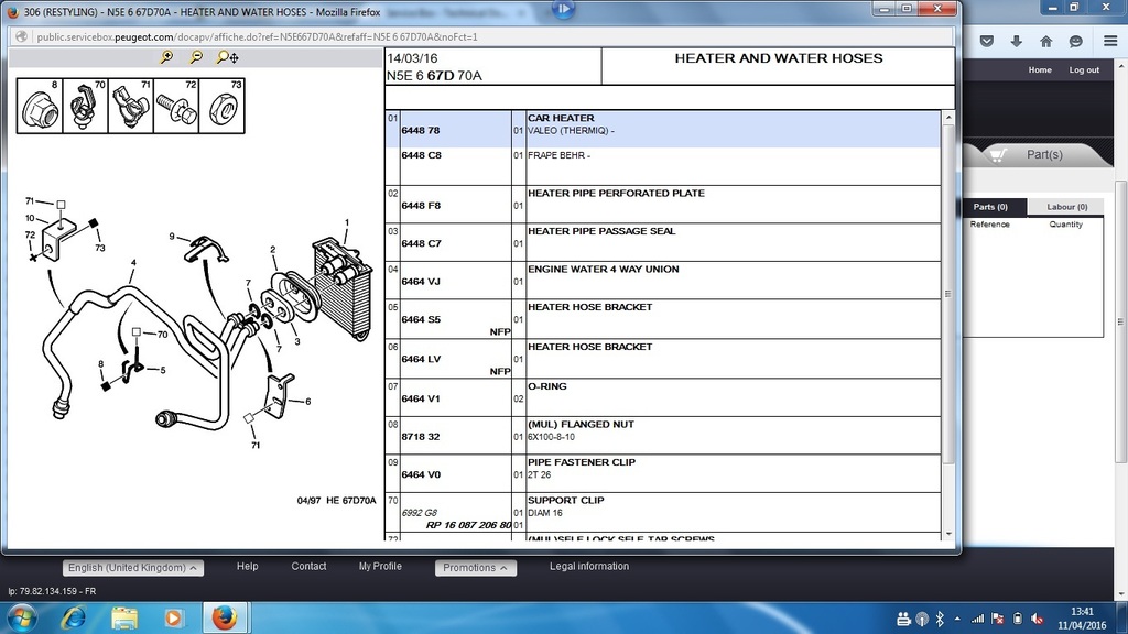

The heater matrix on our latest transport (PUG 306 estate is leaking).
Hell of a job to replace - we know - we have done 2 matrixes on a ZX on the past.
Anyway, the Pug Public Service Box lists both the BEHR and VALEO for out VIN.
We can buy them new here for 11.99euros + 4euros postage (about £13 in total), and it takes about 4 days to come.
They are not original - but are a brand we trust and have used for 10 years (clutches, timing kits - everything really).
We would like to order the part and do the job when it arrives, rather than being without the car for 4 days.
Can anyone tell us how to determine which one we need before taking out the old one ?

What year is the estate? Might be a LHD RHD thing, or AC cars using a different one.

Hello , its 1998 , LHD and doesnt have AC, or CLIM as we call it here.

Thats bizzare, theyre both listed for everything. Even the lhd ones have both.
I'll see if someone will wade in and clarify here, maybe behr is their aftermarket choice?
Edit: a quick google shows its the same across the board, valeo for standard blowers and behr for AC fitted cars

We fitted our heater matrix, bought it new for 11.99 euros. We ordered the BEHR equivalent and when we opened the car it appeared that we should have had the VALEO type. However, the only real difference was the screw-holes. Nicely placed self-tappers and it was in.
Now our car is set up to take either BEHR or VALEO in the future.
