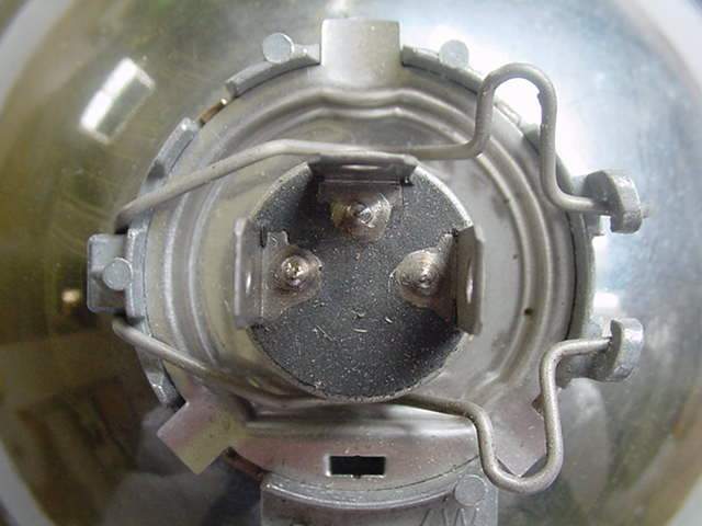

Has anyone got an exploded diagram of the headliight bulb fitment and recess - failing that, clear close-up pictures of them? I looked on DocBackup but it only shows the headlamp from the front.
I find it absurd in this day and age that the design allows for improper fitment, hence why I wonder if mine could be damaged allowing excessive movement.

Is it H4 Mike? -
Shouldn't be possible to get it wrong as there ate three locating 'wings'.

Unread post by Paul-R »
If it's the same as the earlier and later cars then dipped beam will be an H7. Thus it's possible for dip to be misaligned while main isn't.
I think that main is half of an H4 on the earlier car and an H1 on the later car but I stand to be corrected.

I think that the fog light is the H1, but main and dipped are the H4 bulb.
