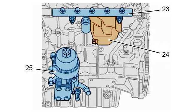

In preparation for the first oil/filter change this weekend I had a look under the bonnet this morning to see if the filter is accessible from the top but couldn't see anything i could reach easily. Where exactly is it? If i have to crawl under the car i would rather pay a fiver and have it done with some other jobs.
C5 X7 Exclusive 2.0 HDi Auto
- Posts: 6846
- x 3566
Re: Pump for oil change
Front face of the engine, slightly left of centre line as you look at the front of the engine, part number 25.
It has a black plastic top to it and you'll need a 27mm socket or spanner to undo it. It takes a replaceable element inside. Info based on a DW10BTED4 engine.
Thought that was the diesel filter
. Easy to change then. So remove old oil - replace filter - add new oil -- done? Any other steps?

The diesel filter should have a few pipes coming out of the top of it.osx wrote:Thought that was the diesel filter. Easy to change then. So remove old oil - replace filter - add new oil -- done? Any other steps?
There should be an O ring with the new oil filter to replace the one on the housing. Yours will probably take a (part number) 1109CK oil filter, there are other filters of the same size but they have less filter material in them so aren't as suited to the longer change intervals. If you undo the oil filter housing a bit you should notice a cut-out in the threaded portion - I presume it's to allow air into the housing to allow any trapped residual oil to flow back down through the housing and into the sump as opposed splurging out all over the side of the engine once the airtight seal is broken
