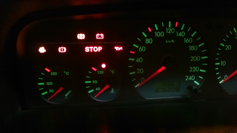

Hello guys... I'm having a problem with the oil temperature gauge in the instrument panel and I wonder if you can help me with this.
(pictures below, taken from another users in the FCForum)
The problem is that the oil temp gauge in the instrument panel does not work. I mean, after some miles (kilometres in my case), the engine temp and oil is higher and the gauge does not show the right temperature, it's always as if the engine\oil is cold\start. I changed the Oil temp sensor for a new one (thinking it could be this the problem) but it is not. I don't think that the problem is the oil gauge temp itself in the instrument panel, because when I turn the ignition key (instrument panel lights on) the oil level orange warning light (image "Controle" top right) always blinks for a few seconds, I must say that the blinking never happened before, just when the oil gauge failed. Is it maybe some errors in the central computer of the car, needing to be erased?? I don't know. If you could help, I would appreciate.

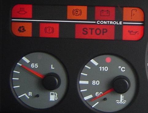

In the first picture the gauge with the light at the top of it is your water temperature gauge, not the oil temperature gauge. These must be EU dials as the UK dials look like your 2nd picture with the water temp beside the fuel gauge and the oil temp gauge on the right hand side beside the rev counter.
Which engine is in your Activa? I know the V6 engine has 3 different temp sensors, Blue, Green and Brown IIRC.
Once we know which engines in your car (2.0 TCT, 2.0 HDi, V6) then we'll be able to offer a bit more help.

Ok, so which gauge is at fault then? Oil or water temp?

Yes... I forgot to mention... it is the Activa with the HDi engine, sorry about that... ;)... it's the gauge at the left in the first picture... CitroJim I take off the instrument panel to see the contacts you mention... well I didn't see anything wrong with the contacts between the gauge and the printed circuit in the back... but it is possible, I might check again.
Surprise of mine that the cover in front with of the instrument panel is a single piece, all the gauges oil\gas\speedometer\engine rotation\temp are the same "blueish" printed panel. When I did that I tried to take off the oil temp and engine temp gauges, but the needles in front are too much stuck in the gauges and I didn't want to force because the gauges are very sensitive, I wanted to put the oil temp gauge where is the engine temp gauge to test if the oil temp gauge is working properly because I know the engine temp connections are working... but I couldn't do that afraid to ruin the gauges. ;)
