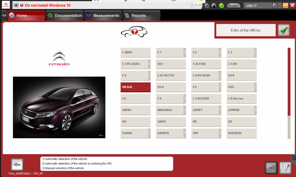

Can you grab a screenshot of the start page of the 8.17? Unless it is blue, I won't be changing mine ... :D

vborovic wrote:Can you grab a screenshot of the start page of the 8.17? Unless it is blue, I won't be changing mine ... :D
The Diagbox Screen with Citroen / Peugeot choices? - Ok, will do tomorrow as the laptop is just installing Windows update number 39,456!
No - looks the same as before - the only blue is on the Measurement and Reports tabs

Thanks for the screen ... I see the "Do not install Windows 10" message is still active ... :D
