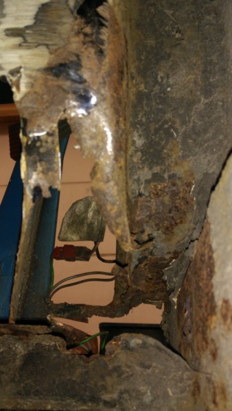

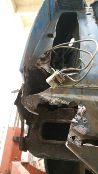

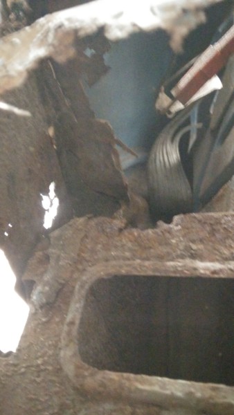

Just wondering how did some of you guys welded this section?
Hard to access rear corner behind the lights common rust area on a AX.
I am restorating it so need some advice of the forum here.
Some pictures from the section that needs to be repaired:

That is going to be lots of cardboard templates and thinking. A bit cut out and welded in where possible to retain profile, then more cut out.
Photo's from before and careful measurement with calipers and a mock drawing. Another car for a reference would be good. Lots of stitch welding and bracing to avoid distortion, then seam weld and cut and grind braces off. That kind of stuff.
There is a great build on a MK 3 Cortina on Retro Rides. I have lost the link but it will give you great method and ideas.

Thanks for your reply,
I was considering cutting it out with a Dremel and refabricate this section.

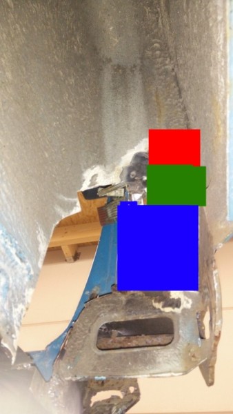

Step 1 is going on now making separate panels and welding in.

Pain in the arse this was on the ax. I was using a 90amp flux core welder and couldn't get it set right so I bird cropped it as you can see in the pic, then stitch welded over the top of it not shown in pic

Yeah, flux core is not good with a cheaper machine and thin panels. Use a copper or ally plate behind the joint.
It will draw heat from the edges and help in getting a puddle and not shooting through.
I find the 4" angle grinder with thin 1mm disc is as good as anything for cutting.......if you can get in. I have every tool for cutting. Air saw, reciprocating saw, plasma cutter, jig saw, nibbler. But if I only had the choice of one.........the grinder with thin disc would be it.

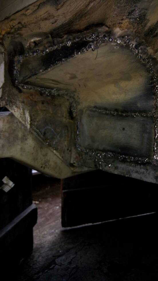

Could I weld like this so that this corner is gone.
jsp
Posts: 330
Joined: 04 Dec 2014, 02:05
x 12
Re: AX 10E rust rear corners welding
Unread post by jsp »
Almost finished hate it to do this but, worth the job saving such an old car:
