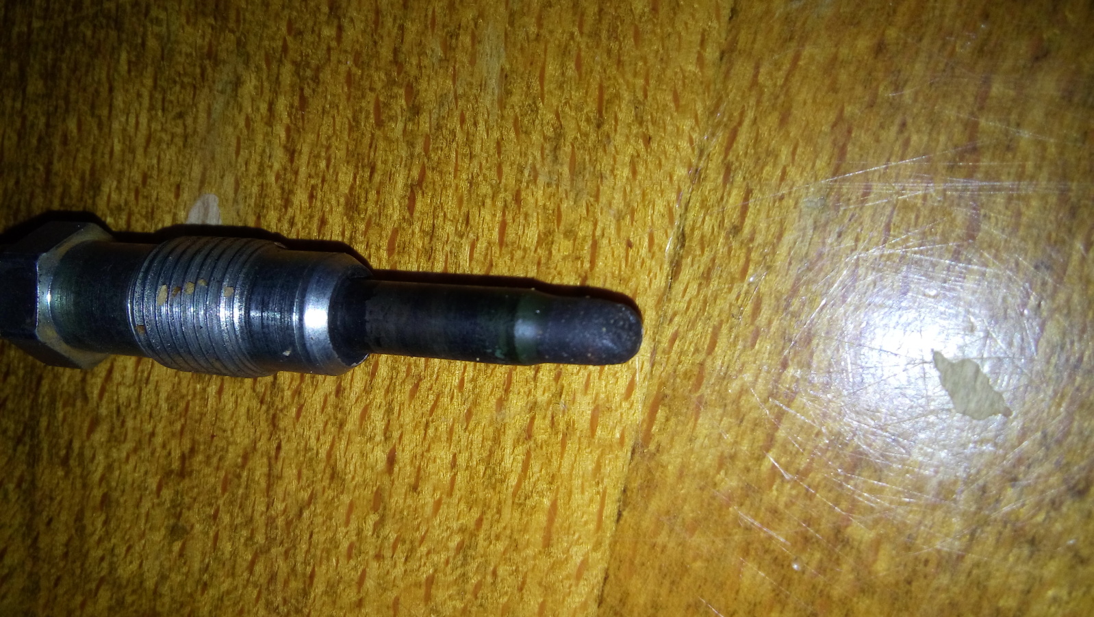

Well the problem is that it gets "eaten" at the tip... Maybe WVO is too aggressive? Did a bit of research and people running WVO have similar problems, plugs not lasting more than a year. Plugs with ceramic tips might solve the problem, but as far as I know they are quite expensive...
You can see on the image that the tip is "eaten" just after 4 months and the plug is scrap...

WVO is quite corrosive, it's all the impurities in it I expect... I've seen what it can do to pumps...
What brand were those glowplugs?

NGK (Y924J).

Personally, I never rated NGK ones very highly... Try a set of BERU ones...
