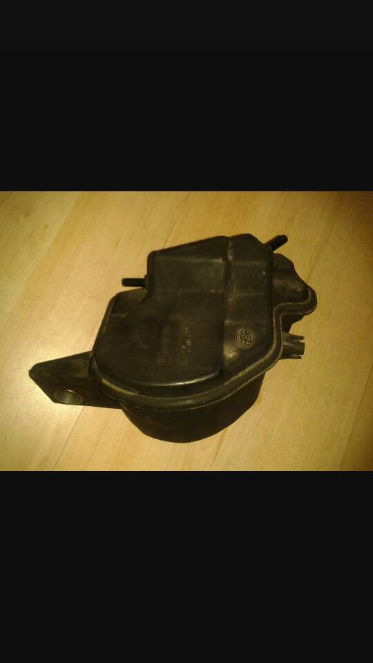

Mine has got a totally different solenoid to the diagram I found an identical one on a peugeot forum Image
Sent from my SM-G900F using Tapatalk

paultintin wrote:Mine has got a totally different solenoid to the diagram I found an identical one on a peugeot forum Image
That's the reservoir..... solenoid should look like this:

I was just going to say the same Richard! 1 on the diagram is the Solenoid, 3 is the reservoir which is what you have! :-D

Ah I see well I found the reservoir then but not the solenoid reckon I will ring citroen tomorrow for a price to do the job as I'm at a loss to find the bloody thing lol thanks for all your help guys
