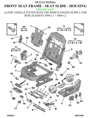

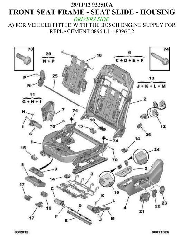

Right - Here's the diagram. (I've PM'd you for an email to send the parts list off as it's too long to post here). According to this, 12 is the harness part for the Driver's seat 6505 A2 (or 6505 A3) for the passenger side.

I did have a look at this picture, but part 12 did not "talk" to me a all.
For me 12 is the electric connection from the seat to the car loom.
19 is the heated pad electronic unit, so we are looking for what is connected to it
What this picture does show is the heated seat pad or the cushion making up the seat
