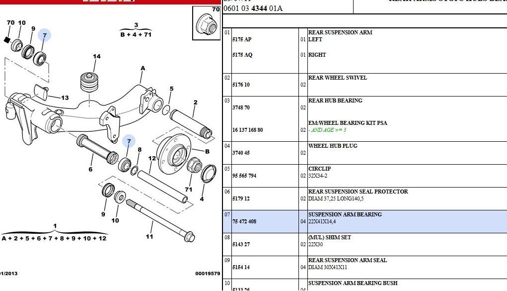

The rear Axle ?? there is no rear axle as such as the car mounts "Trailing Arms" onto a fixed cross member, the arms carry a Wheel "swivel" which carries the hub.
Not really sure what you had replaced. IF it was a complete refurbished trailing arm then this will of been fitted with new bearings (or should of been).

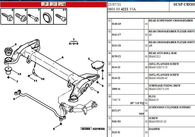

Stickyfinger, I paid for the full assembly - i.e trailing arms and rear suspension crossmember, with all new bearings and bushes. The price was £350 part exchange (my old assembly) plus £100 fitting charge.

Well, it doesn't sound right to me - I've not heard of many people having their suspension crossmembers replaced - mostly the trailing arms bearings are the cause of the creaking noises. The cheapest option is to get a report - here's Citizen's Advice on this very issue -

GiveMeABreak, I think the reconditioned axle service is probably attractive to people who just want an expedient solution to the trailing arm bearing problem. Someone else does the bearings and bushes, you pay for the completed assembly and get it fitted. In this instance, I paid for them to fit the assembly as well. At the time I didn't know of, and couldn't find, any garages near me that were willing to take on Citroen suspension work - it seems to strike fear in the hearts of many - and getting the job done by a dedicated axle reconditioning company seemed at the time to be a really good option. Of course, with them being obstructive now, this is something I'm beginning to regret.
Stickyfinger, Pleiades appear to be a 260 mile round-trip for me. Not really feasible, tbh. The guy that replaced the spheres suggested that the reconditioners probably applied new bearings and bushes to trailing arms and/or crossmember that were "egged" - I think he means that they were worn due to long-collapsed bearings wearing them out of shape, I'm not technical and was struggling to keep up - but without performing a complete disassembly to examine the parts with his own eyes, didn't feel he could assert this without uncertainty. I can't afford the time on the guy's ramp for him to do it, and being a Yorkshireman I'm stuck wondering why I ought to pay in the first place. The thing's under warranty and it's gone bad - it's barely any better than it was when I paid £450 to replace the old assembly, and it's well within its 2 year "no quibble" warranty. If I had spare cash I could pay for an independent assessment and chance that I could recover those costs, but I don't have spare cash and can't chance anything

I've been in this game long enough to know that just because a component is "new" it doesn't mean that it is not the problem. Learnt the hard way. At the MOT there was evidence that either something was not fitted properly, a new component (a bush) failed relatively quickly or that element of the assembly wasn't refurbished and the original bush(s) was/were retained. On the rear axle there aren't a lot of wear items, bushes, arm bearings and wheel bearings.
The axle refurbishers could have received faulty new parts which have failed, well that is their problem, not their fault, but still their problem which they need to take up with their supplier after they have sorted you out.
In the past I have changed the arm bearings on a BX where all that was left of the bearing was a pile of rust, the arm was obviously damaged but it was still possible to fit new bearings (and the car ran a further 200k miles + without problems). However the damage was so obvious that no one could have missed it when fitting new bearings.
A failed new component, incorrect fitting, or reusing an old component if they are claiming (and charging for) new is their problem. The last option, that damage has been caused while driving the car over the last 6 - 7 months, for example by hitting a pot hole, is not their problem.
Having driven BXs and Xantias all well passed 200k miles I've never had to change a subframe bush and although I've changed a fair few rear arm bearings they've always lasted for 100k miles + before needing doing again despite the state of our roads.
