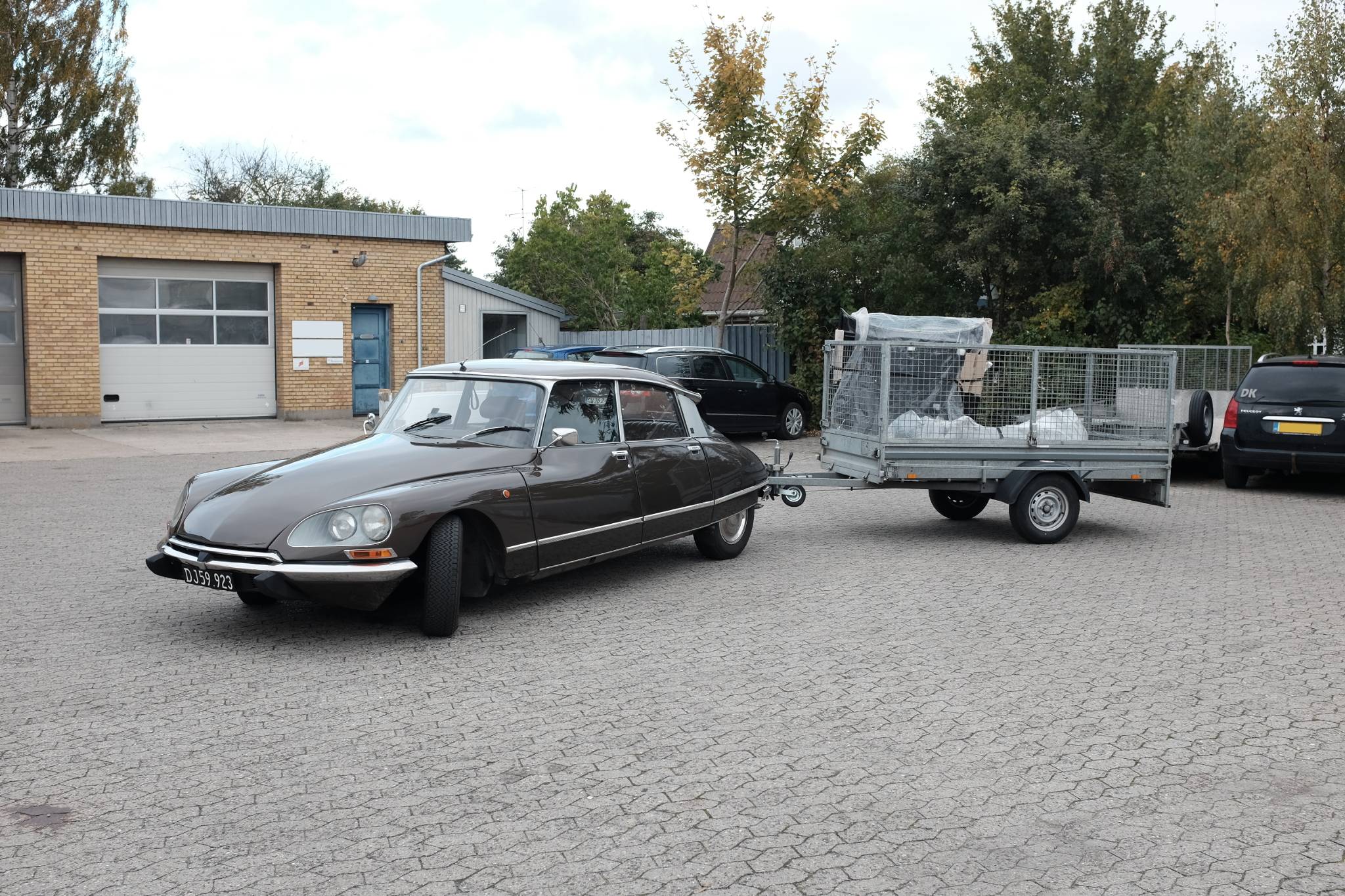

Just a quickie:
My DS hauling spare parts (bonnet and front bumper) for my Activa V6.

Lovely ^
