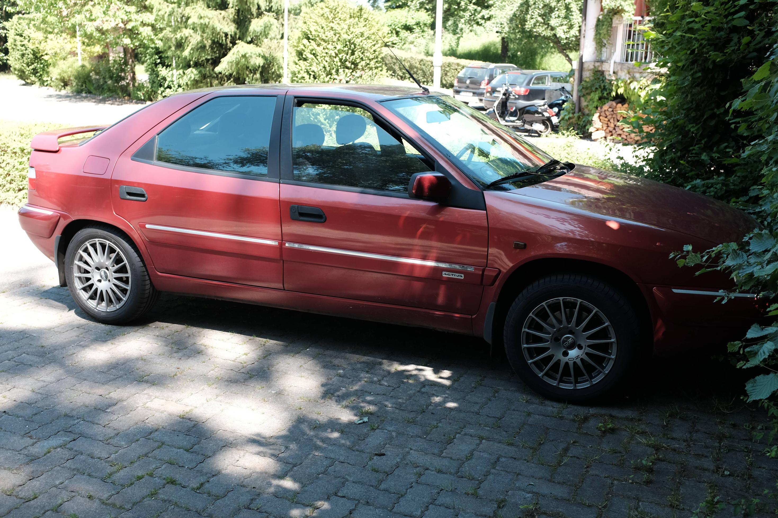

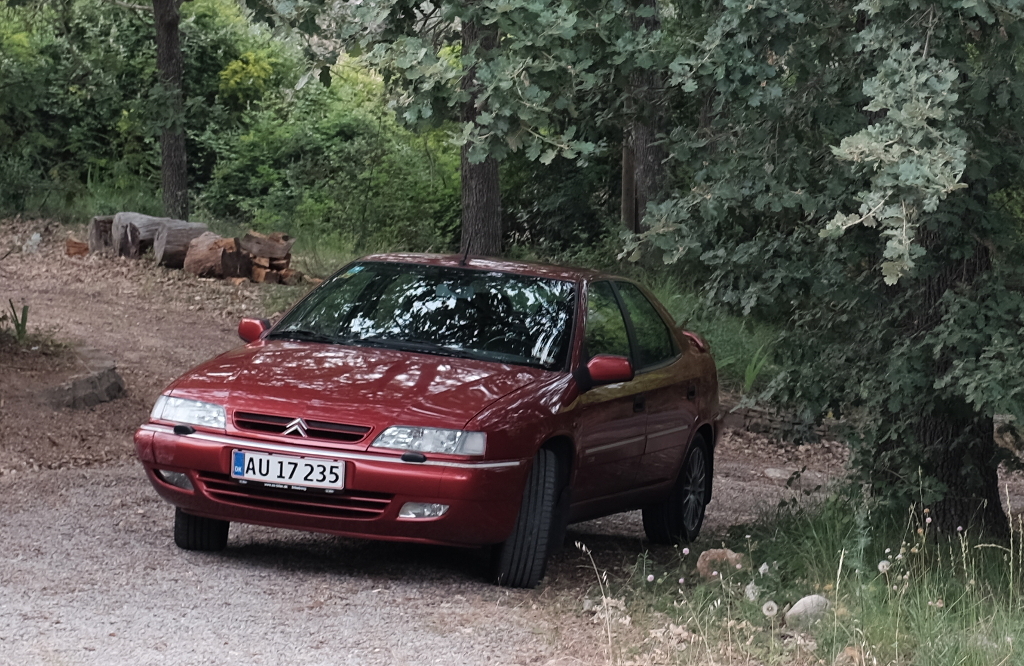

This is slightly embarrassing, because I don't actually have that many great pictures of my car. I think it might be my reluctance to take picture of it due to a slightly of patina on it that I intend to fix (in particular its front bumper).
But these two are OK-ish:
