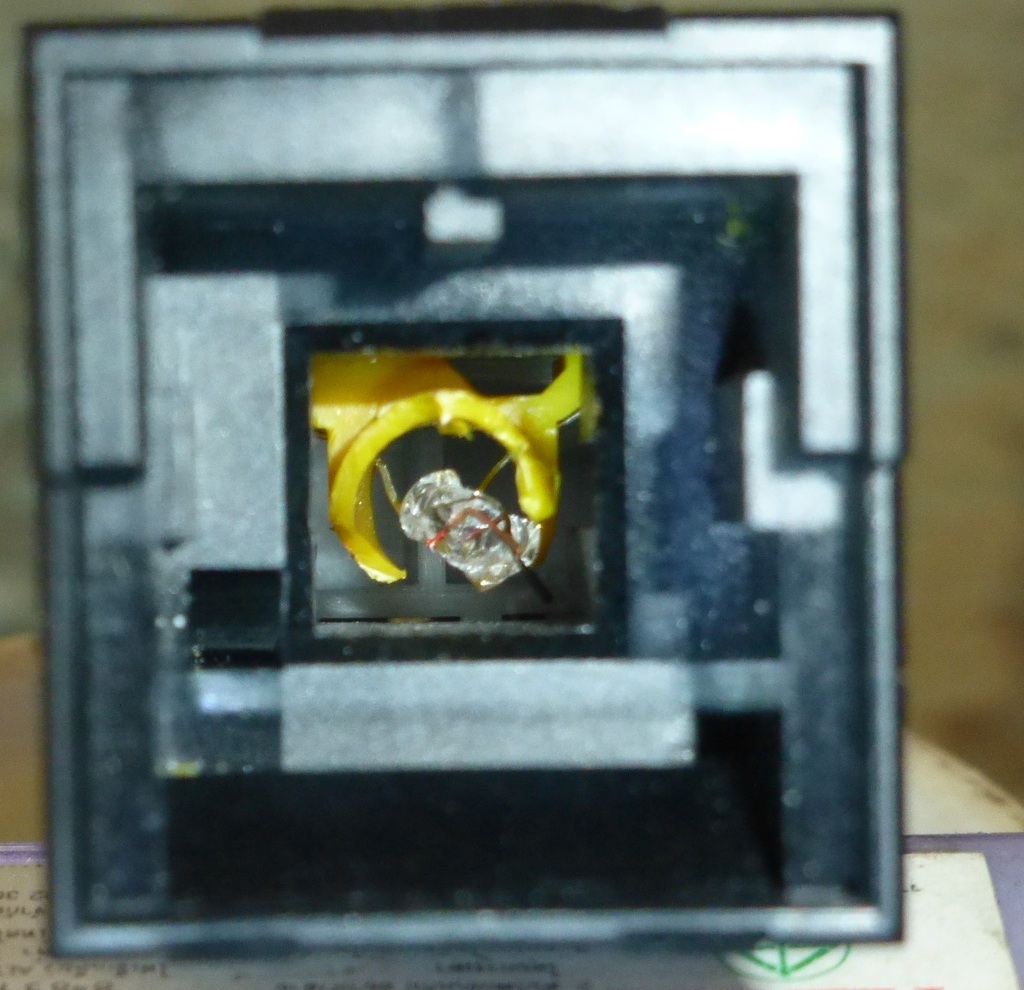

I've now had time to go through the sequences throughly and the two that are not performing to specification as citroenxm outlined are the Rear Fog and A/C switches.
I have prised open the A/C switch and the interior is not as described in the Topic that Xantia V6 pointed me toward. With the top off I see a small green (but very discoloured) plastic cover, presumably over the bulb, and it's the discolouration here that keeps the thing dull all the time. So the issue is I can't see any means of removing this easily, hence it may be better to just replace the switch.
The Rear Fog switch seems to respond on some ocassions, not on others. Also sometimes it has the backgound light, others it's just a blank. I guess this may be else where in the system which may not be in the switch itself - has anyone had this experience?

When you can see the green cover, you should also see the edge of a small circuit board going across the switch, supporting the bulb. This just pulls out, and everything should become obvious.

Tested To Destruction.
Try as I might I could not see anything that pulled out.
(This was a 'faulty' switch that came in the odds & sods bax with the car, so I don't feel too badly about it.)
Posts: 11014
Joined: 09 Nov 2005, 22:03
x 1484
Re: XantiaX1 Fascia switches
Unread post by xantia_v6 »
Ah... The black plastic (moving) part of the switch needs to be pulled out first.... Oops.

And how does one do that without removing the switch from the dash please?
Saraphee
Posts: 111
Joined: 04 Dec 2015, 06:11
x 11
Unread post by Saraphee »
and, having removed the switch from the dash am I missing a trick in not at first atempt being able to separate front moving part from the body?
Forgive all these questions. I haven't done this sort of thing for 30 odd years, I have usually caused others to do it for me.
