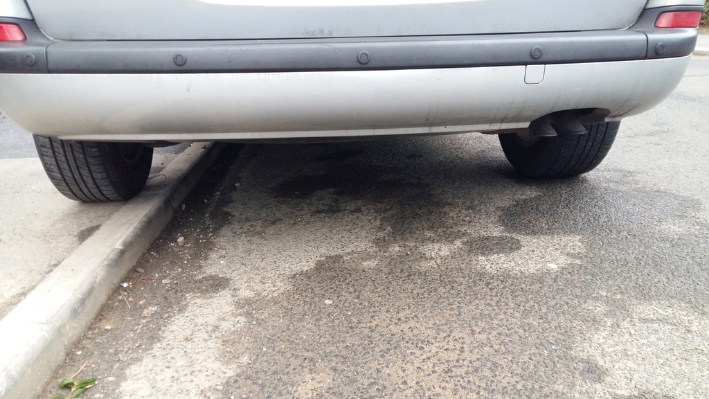

hey guys. ok so im wanting to fit parking sensors to my 04 plate 2.2 hdi and was wondering if anybody has fitted after market ones with success? i have fitted them previously to a 02 plate mondeo and had to dig a little of the expanding foam away from behind the bumper to make room for the sensors and wiring. is there any foam or a metal bracket behind the bumper that would stop the fitting of them? cheers guys :wink:

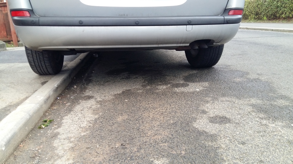

Hey ben just to let you know it is possible to fit parking sensors. The kit i bought was £15 quid and they fitted pretty easy. They is a metal bar behind the bumper but there is enough room to fit them. The kit comes with a hole cutter which i used in my cordless drill. I will post some piccys up of the finished job :)

Looks pretty neat :)
