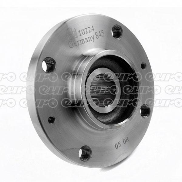

just had a look at Eurocarparts.....they have a front hub with bearing for the Xsara Picasso at £40.26.
That may save the worst element of the job.
