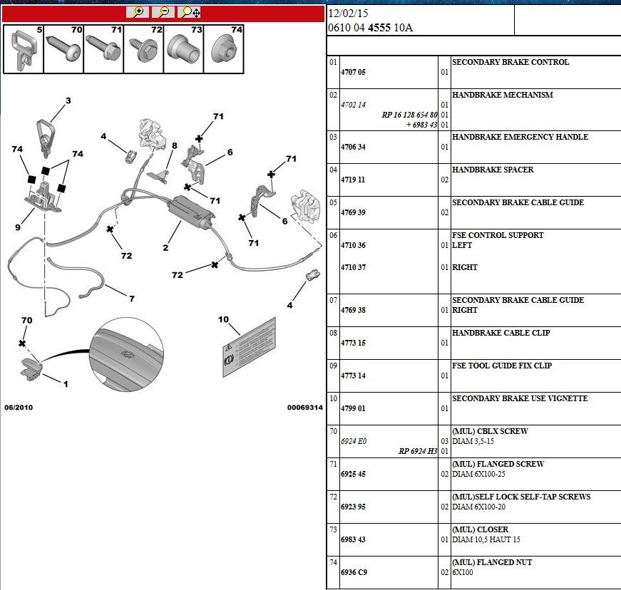

Is it all or the unit, ??
Does this help anyone

I need the whole unit (box + the manual strip + rear brakes' cables).
