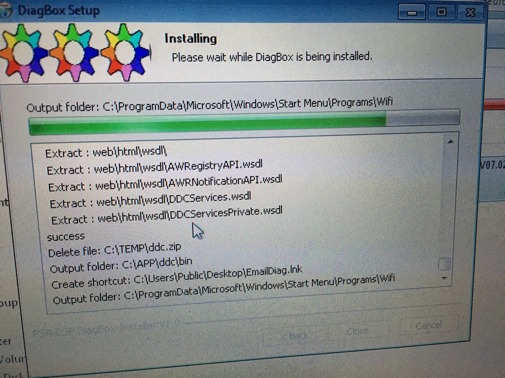

I'm trying to install on a fresh install of Windows 7 32bit, but once Diagbox has installed, it won't accept the code I was provided with and reverts to the error code '0' failure and won't progress to install Lexia or PP2000.

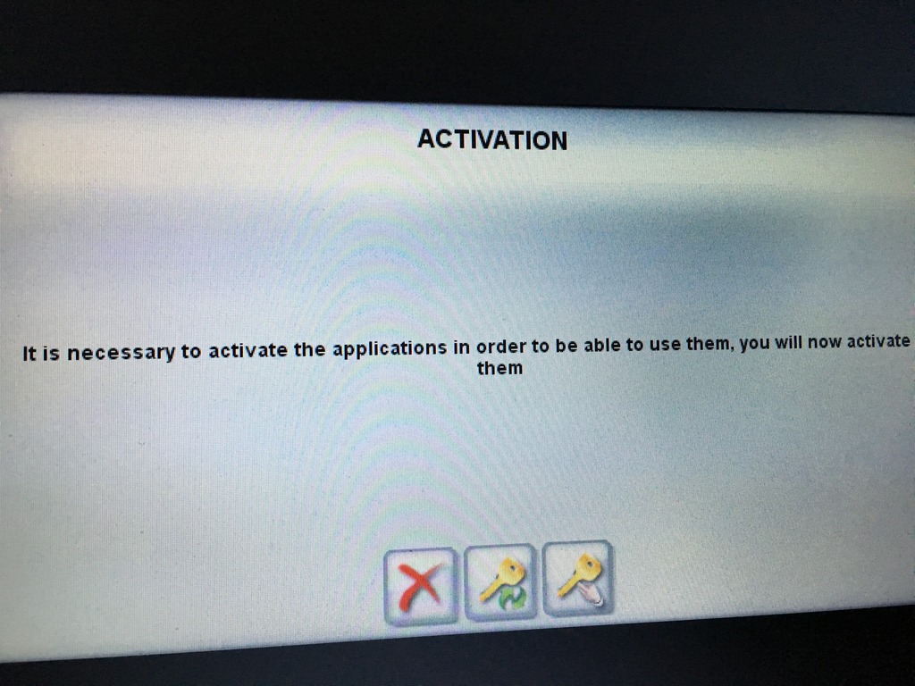

The screen that I get to for Diagbox installation tells me to activate.
I get three options;
A red X
Auto activation
Manual activation

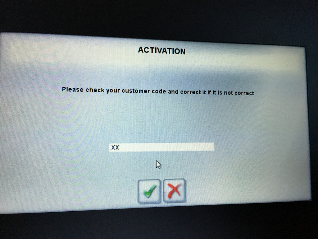

I select manual, which takes me to a screen to enter a code.
The code I was given was 7 digits (1234567)
I add that to the field (which was already populated by two X's, which I deleted) and hit the green tick box.

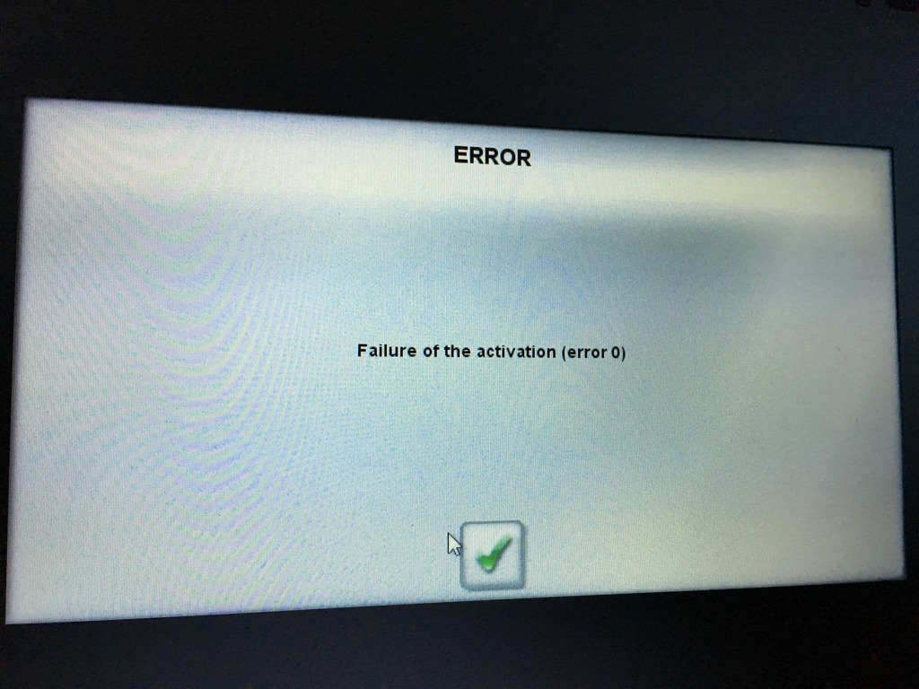

It then comes back with a failure to activate message, error code '0'.

No, I install:
Then this:
So I add the 7 digit code provided with the kit, and get this every time:
I have an old XP machine but it's well past its best, the info I got with this kit state that Win 7 32bit is compatible, I'm not too sure where to go with it now TBH.
Then this:
