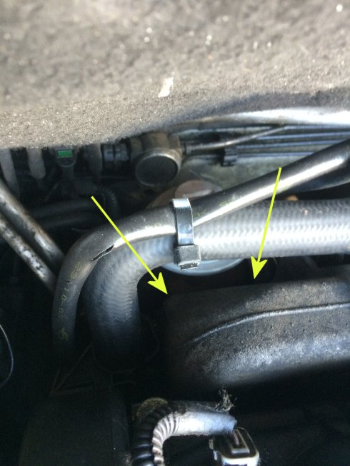

In the pursuit of fixing the dreaded anti pollution error on my 2004 C5 2.0HDi, I have changed the EGR and it's really easy. 30 minutes max. If I've described any parts wrongly, feel free to correct!
After removing the engine cover, look at the right side back of the engine and you will see the heat exchanger pipes which run from right to left at the rear. Remove the 13mm bolts indicated (there's one under the pipe accessed with an extension). You might get away with just loosening them. Then remove the 10mm bolts that can't be seen. There are either 4 bolts or two bolts and 2 nuts - I can't remember. But they are all in that right side area. The idea is just to get the pipework loose, not to remove it. Try not to let any gaskets drop down - keep a bolt loosely in place to hold them

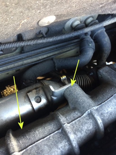

Remove the two bolts holding the exchanger in the centre part. One on top and one under the pipe:

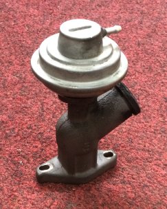

You will find a hose clip holding the EGR valve to the exchanger. Loosen it and leave to dangle. Remove the vacuum tube. Using a 10mm ratchet spanner, undo the EGR bolts which you will have to reach by feeling. The picture of the EGR below shows that they're right at the bottom of the EGR. Try not to pull on any other vacuum pipes. Refitting the turbo pipe is a bitch. :oops:
If everything is not loose, then I've forgotten a bolt somewhere! You should end up with this in your hand:
Obviously, perform the opposite to install. REMEMBER the hose clip on the EGR - if it falls off, it's a pain to retrieve! :oops:
