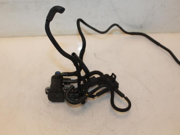

A person I got to know just days ago shared similar experiences with a 407. He pointed my attention to the vacuum relay, that thing here:
https://cdn.proxyparts.com/parts/100251 ... 929887.jpg
So, it's next on my list to try. The guy advised that I temporarily disconnected the thicker vacuum tube at the ?pressure converter / exhaust control?
https://www.car-parts.ie/car-parts/vemo/p-14770436 but I didn't do any mods myself.
Will talk to the garagist again...
