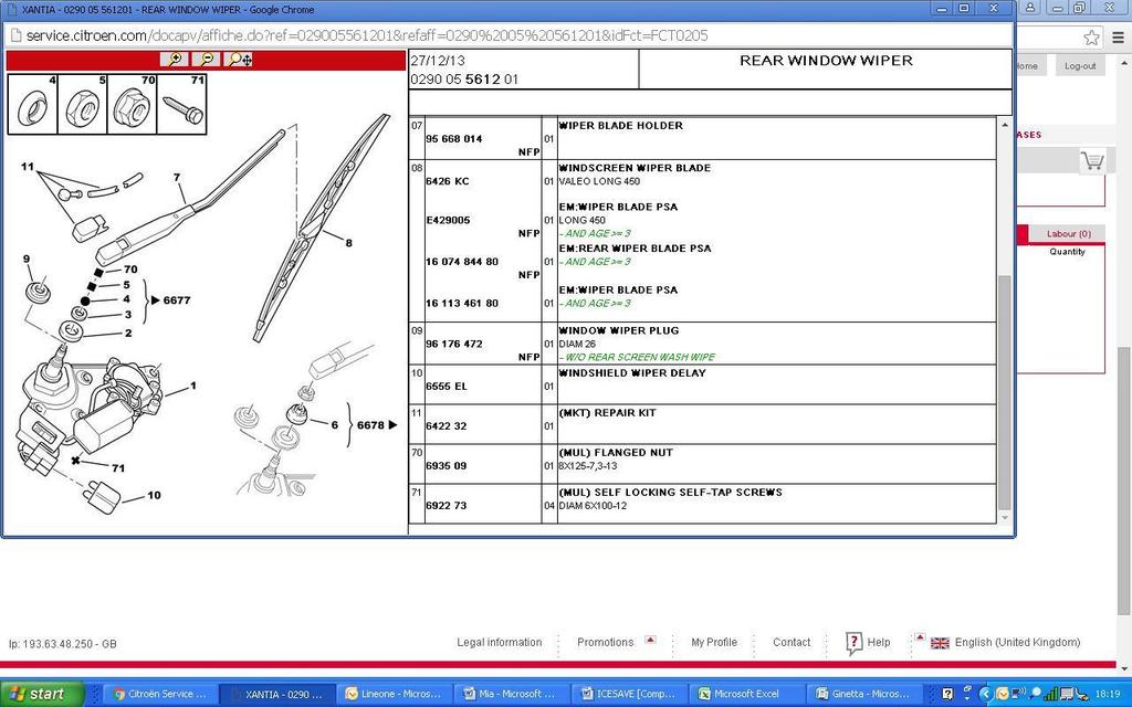

* Can anyone tell me if there is much difference between Mk1 & Mk2 rear wiper arms. Mine seems to be missing a cover over the nut. All the photos I've seen show it covered, I can't seem to find a similar one on my friend eBay and was wondering if a Mk2 would substitute?

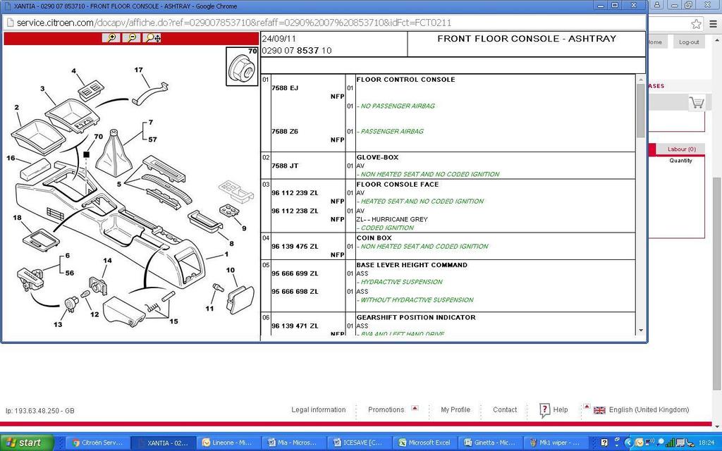

* The handbrake slot in the centre console has a broken piece of plastic at the far end, held in place by a metal rod and a spring - I assume this was some sort of cover, I don't suppose it will be easy to find such a small component.

Are these any good to you.
Part number for the bits shown as item 11 is the same for the MK1 and MK2 so I guess they are the same.
Can you identify the bit you are talking about on the above diagram?

Mk1 and Mk2 rear wiper arms are different. On the Mk1, the washer hose goes up through the arm, on th Mk2, it sprays from the top of the window.
The Mk1 covers are frequently missing or broken.
