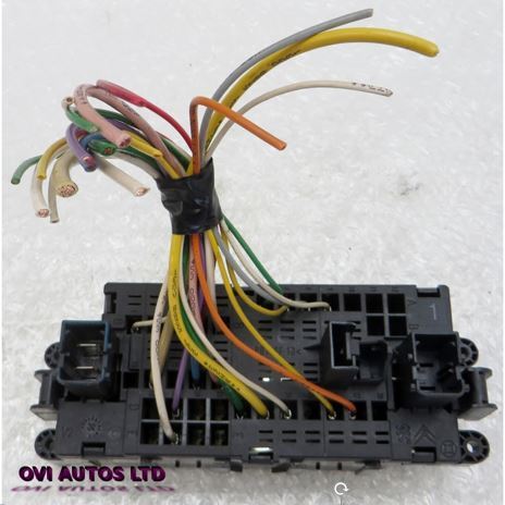

I posted a thread on this problem and since it didn't happened again ( I guess since spring came and then the summer ) I didn't cure it. Now as the winter is back it happened again. I check on it and found out that the problem is at the fuse box under the steering. When it happened I measured the voltage at the pins of the Bitron relay connector of the ignition ECU and one of them had only 7.5 Volts while the other showed 12 Volts. I took a hair fan/drier and heat the fuse box. After couple of minutes I measured 12v at the connector pin that previously showed 7.5 volts. Today I decided to detach the fuse box in order to clean the contacts. After removing the screws that secure it to the dashboard I found that it is not detachable since most of the wires are hooked. I found two photos on the web of the same fuse box that came out of a Xsara
Top image
Bottom image , no connectors , wires cut in order to detach:
How do I detach it without cutting the wires ?

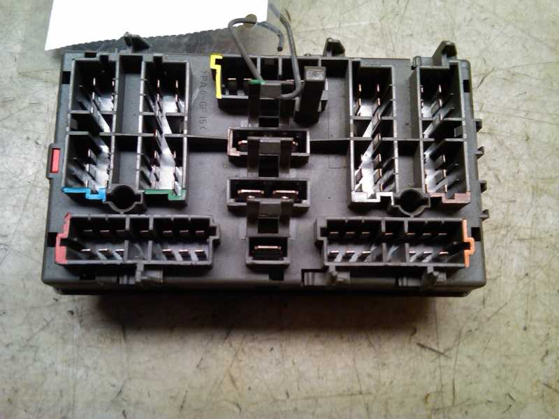

The fuse box for Xantia MK2 is different, I dismantled a year ago and I remade all the soldering.
The fuse box is detachable and all the wires have jacks.

The one that is mounted on my car is the same one as in the pictures I added to the post. I guess/hope there is an easy way to detach it. I think the only way is to open the lid and remove it wire by wire , remembering how to hock each wire back
Thanks

I got a 1999 scrap Xantia and it has the same fuse box xf1ref posted, BTW on Citroen service my car's fuse box catalogue number is 6500H5 that is the same one as xf1ref posted, so there is a mismatch between what Citroen service shows and what is installed in my car, it is not the first time of a mismatch though.

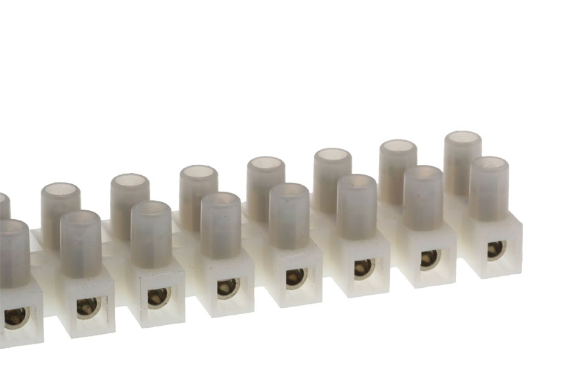

In your case I think you should cut the wires and remake all the soldering at the fuse box.
After that you can simply connect the wires with some cable connector with screw.
If you have enough space you can solder the wires directly and you can isolate with some thermo shrink tube.

I found a used fuse box that is identical with mine ( I posted a picture ) that I detached from an old Citroen Berlingo, . I learned how to take it apart, and remove a terminal from the fuse box. I checked the fuses in my Xantia ( that are mounted on the fuse box ) and found a 10A fuse that its plastic cover is distorted as a result of heat. I pull it out and it affected all the items that behaves "weird " when it is cold. I guess the terminal inside the fuse box has a bad conductivity. Next step is to take apart the fuse box on my car pull out the suspected terminal and replace it. Since I am going to take it apart I am looking for the fuse box wiring diagram and the engine ECU connector pin assignment, does anyone have these diagrams?
A weird thing is that Citroen service shows that my car is fitted with a fuse box that "xf1ref " posted its picture although the one that is fitted on my car is the same one I took of the old Berlingo ( make year 2000 ) and identical to the picture I posted. Even in the original User Manual that comes with my car, the sketch of the fuse box is like the one "xf1ref " posted its picture . I am looking for a User Manual at witch the layout of the fuse box is identical to mine so I can know the function of each fuse
