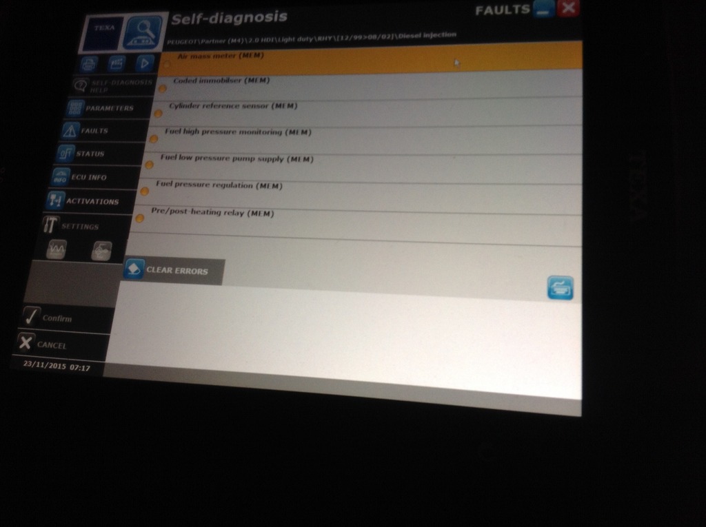

Gave car a service, since then it randomly cuts out and throws up po230, primary fuel circuit malfunction so I narrowed it down to a dodgey Bosch high pressure fuel pump, then it was perfect, 2 days later it started again and discovered in tank pump was shot so fitted a brand new pump. I discovered the in tank pump was a vdo Siemens, the high pressure is Bosch, so I replaced in tank with a genuine Bosch unit, still no difference, I replaced the twin relay, still no difference

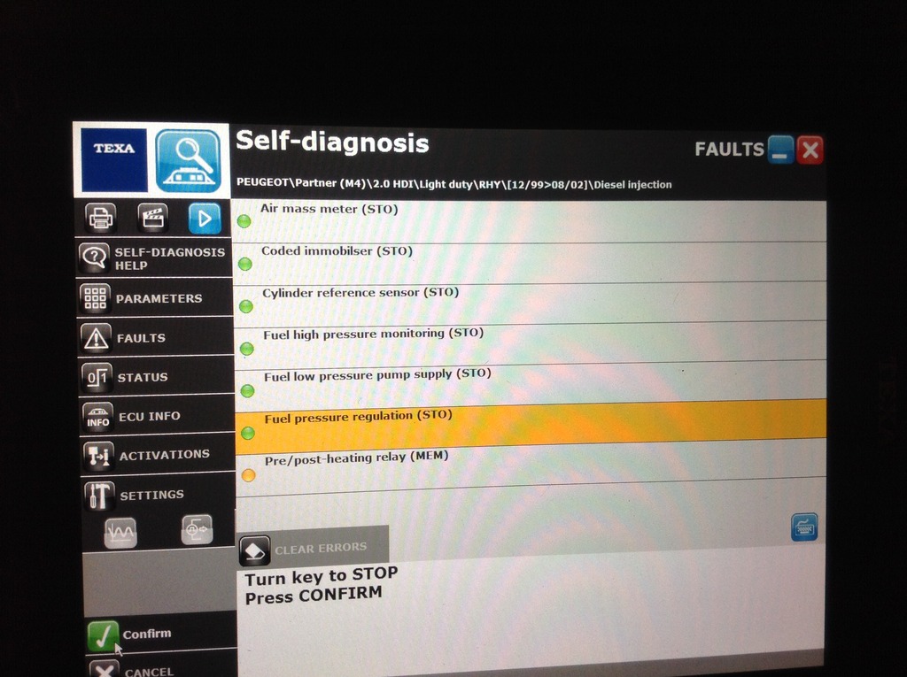

I then removed the fuel pressure regulator, cleaned and refitted, then it was perfect for app 20 miles, then the cutting out returned, still none the wiser I took it into my hgv workshop and used our hgv/lgv reader, a £7k bit of kit so not An eBay special which bought up multiple stored codes ( some caused by me whilst unplugging sensors etc) but the only one that will not delete is po380 glow plug relay, it's showing as an active fault.... But what's stumped me is that code will not clear, surely that won't cause it to just cut out, it's defiantly a fuelling issue as when it dies, it's very quick and abrupt, then you have to leave it like 5 mins before restarting.
The fuel rail pressure is good, 400ish bar. What's wrong with it, any ideas, me and my colleagues are all stumped so hoped someone hear might Have encountered it before.....I have a video of live readings from the car if it helps

Your primary circuit fault was almost certainly due to the in tank pump. The lp in tank pump brand is irrelevant. In all likelihood the vdo one was there since the car was manufactured. All that pump has to do is supply diesel at about 2.5 bar pressure. You probably let some of the dwarf through into the hp pump when changing the filter. Also I assume the replacement hp pump was second hand so you do not know what state the regulator filter was in when you fitted it. The filter cannot be effectively cleaned.
There is a typical fault caused by the regulator clogging. At certain engine speeds the rail pressure becomes uncontrollable. The ECU then stops the engine. It can be restarted as soon as the pressure drops. Some of these regulators, particularly the ones for Mercedes do not have a filter. However they can still clog or dwarf can prevent the needle from seating making starting unreliable. The only purpose for this filter is to protect the valve in the regulator itself. You can remove this filter without risk of damage to any other part of the injection system. If the cutting out ceases you have found the fault.
As regards clearing the fault on the glow plugs there are two possibilities. The most likely is that the circuit self tests immediately after clearing the fault and the fault is still there. The second is that the diagnostic system you are using might have an incompatibility. I think you can safely ignore this fault. I guess you are probably using the texa system.
