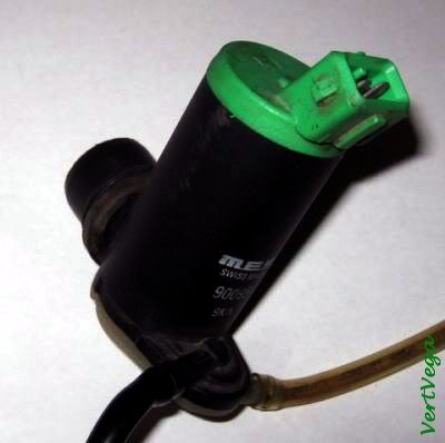

There is one pump motor for both front and rear. It has two outlets as seen in the picture. This is a small pump (smaller than the headlight jets pump) and doesn't make too much noise.
- Defective pump or blown Fuse?
- Water pipe popped up? Common place to start checking is the bonnet and windshield corner.

Washer motor looks like being the motor then, the fuse is fine and the hoses all are too. Weathers not awful today so I'll have a crack at something.

the washer pump is common on most psa cars of the age, if you have a local breakers that still allow you to walk about they are an easy spot, 306/206 etc are in the engine bay, ours in behind the arch guard, i think my breakers charged me £3 for one!! - had a picture on the phone of what i needed for reference,
