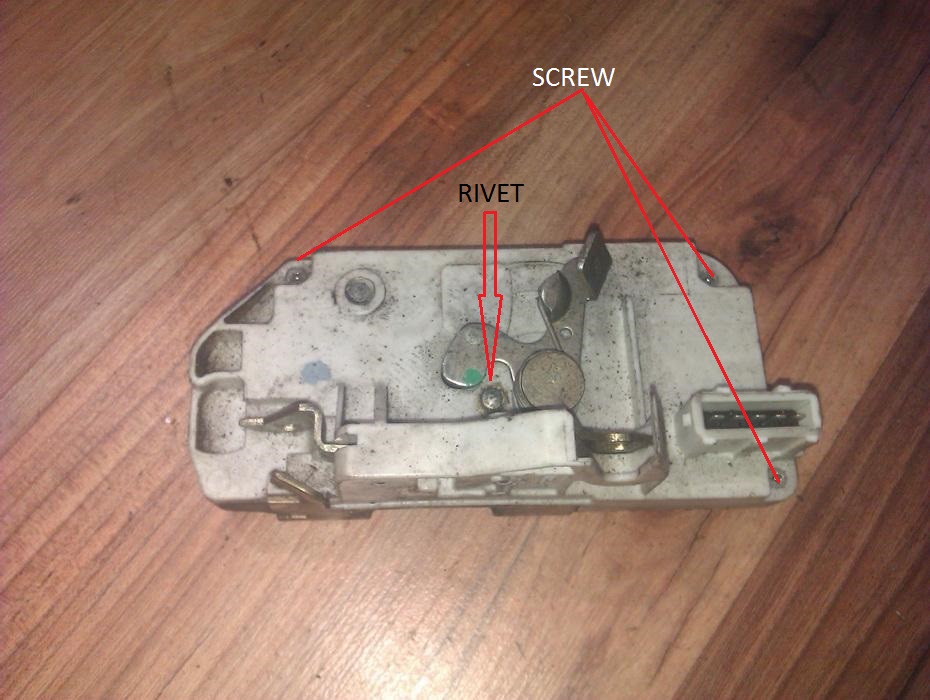

It is good to know they can be fixed :D
How do you take them apart to access the insides?

I also checked all the locks directly on battery, but the behavior is the same for all. I even changed the eletric engine with one from front door lock, but same result. I destroyed a whole set of locks to remove the electric engine for left rear door lock...that why I think the wires are good...maybe I have bad luck.
To acces the insides you have to cut the head of the rivet with a powerdrill and to remove all three screw...is not complicated.
Inside is the mechanism and the switch for interior lights and the indicator light for doors in the dashboard.
