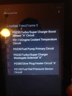

Upon searching through hundreds of pages online, many of which are from this forum I am just stuck. I was able to dig out one of them little ODB scanners from an old car which gave me several fault codes...

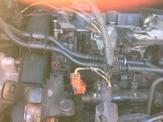

The only glaring problems I found on inspection were a few wires that the coatings were completely worn off, I thought that these could have been causing some issues so I cleaned them up and re-insulated them...
http://tinypic.com/r/2uhlqut/9
http://tinypic.com/r/2m5gvnn/9

Erase all the faults. See which ones will not clear or will come back very quickly. Ignore the glow plug one.
Look at the live data. See if anything seems astray, in particular manifold or boost pressure.
If you get a series of boost related problems back after a short drive.
Check f15 in the underbonnet fuse box. Check that the 2 solenoid valves (egr & wastegate) are connected and have a 12v supply. Check the resistance of the coils, 20 ohms. Check the vacuum pipes on both if these. Check that the vacuum actuators are not leaking. Check that the wastegate actuator can actually operate by applying vacuum to it.

It looks likely that either the wastegate vacuum solenoid valve or its associated hoses have failed - not uncommon.
If the hoses are intact and connected, try temporarily swapping the EGR and wastegate solenoids.
