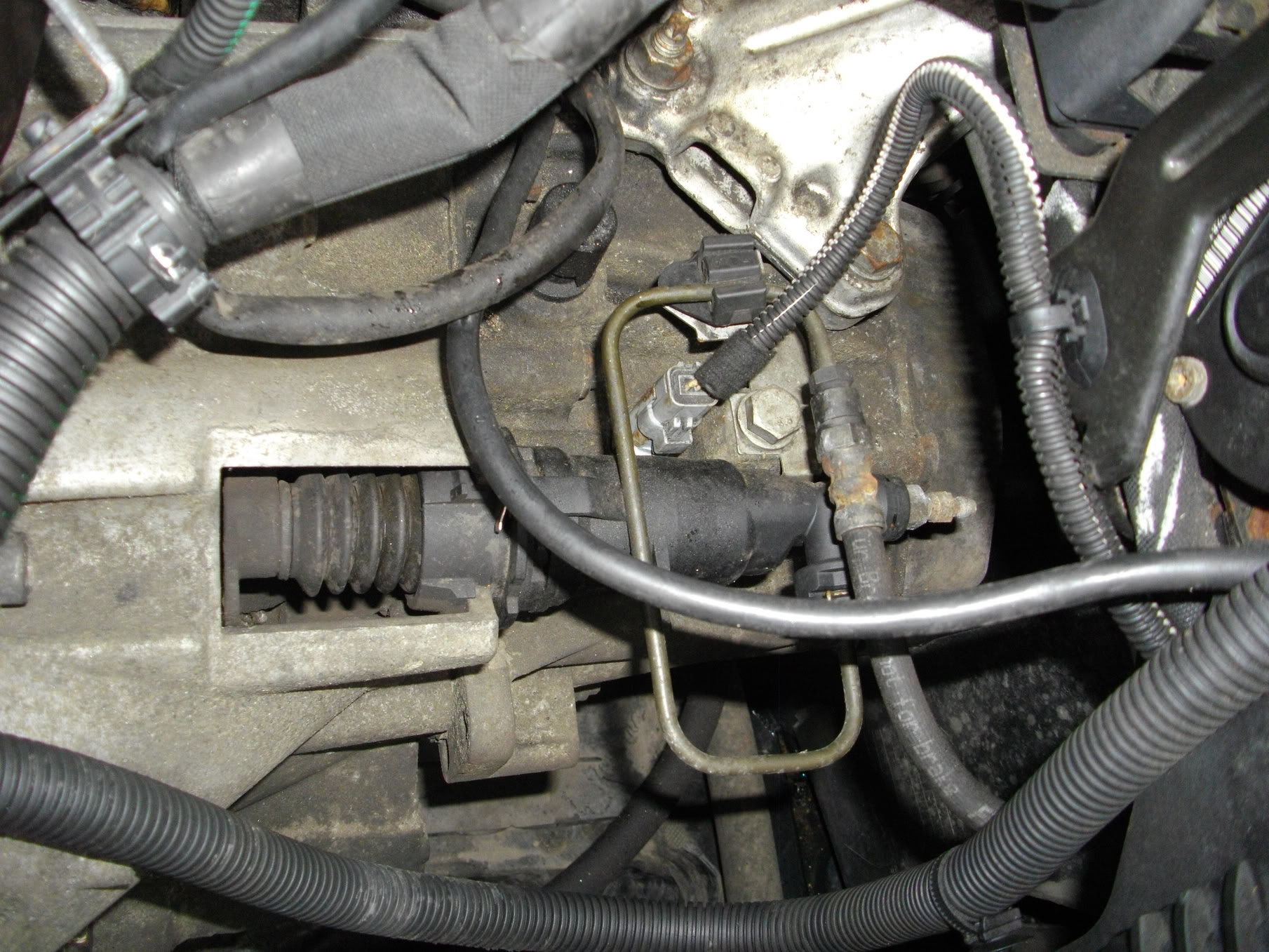

The clutch and brakes share that reservoir. Low level may be linked to the clutch hydraulics.

I would be looking at the clutch slave cylinder, on top of the gearbox.

I checked clutch cylinder above gear box and all dry. I also looked at brake fluid reservoir and master cylinder/servo, all looked dry. I also checked brake calipers and no fluid visible. I am still (slowly) losing brake fluid and there is no pedal travel. Any more idea's please?
