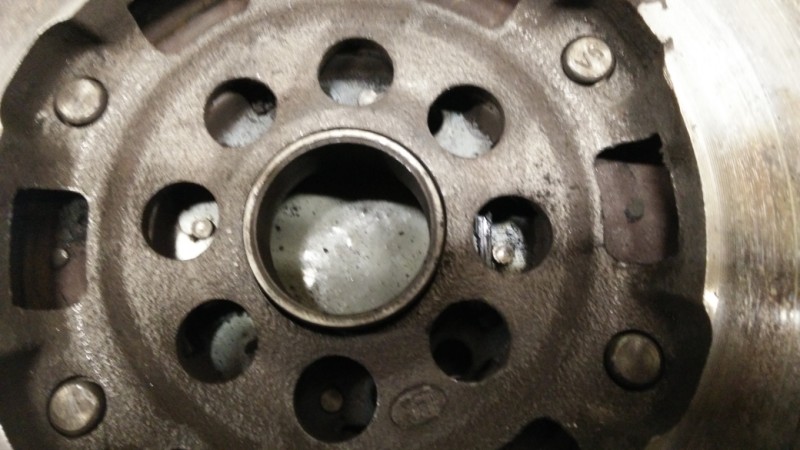

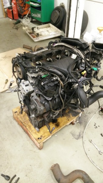

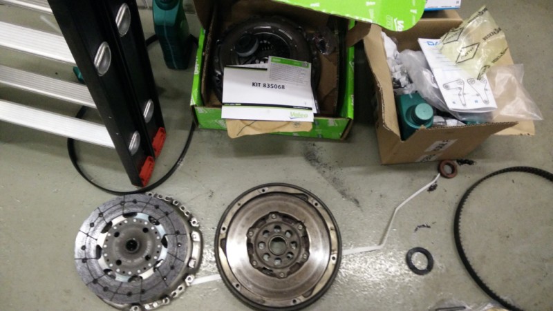

After a long Thursday and Friday got the engine out:
LUK DMF with some loose parts between it:
KIT4P going on it:

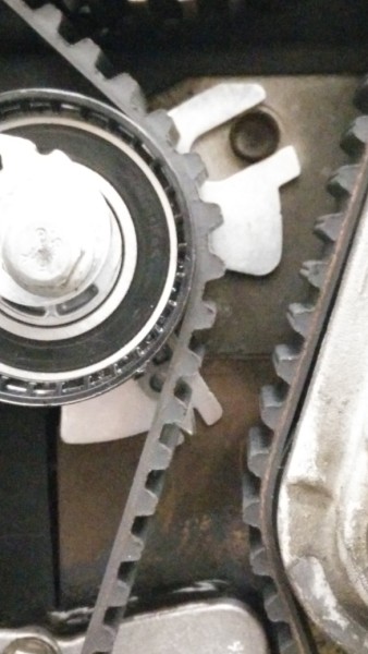

Does anyone know which one is correct? and which notch upper or under to use for pre tension?
And I also have removed the camshaft pulley to replace the seal behind it does anyone know the Nm/ft.lbs for the camshaft pulley is?
KIT4P going on it:

You have not taken any notice of our advice ?
There was no need to go to all that work and remove the engine,also we said its best to fit a new DMF. So best of luck.
