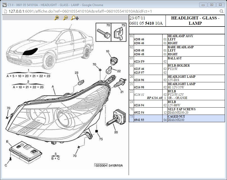

Hi Begins, here is the tech excerpt for your C5 based on your supplied VIN. It is a D1S Bulb. VERY high voltage here so would suggest disconnecting battery and then flashing lights to discharge any residual current if you are going to do this yourself. Also, suggest you change in pairs.

Citroen Part No: 6216 96 Regards
