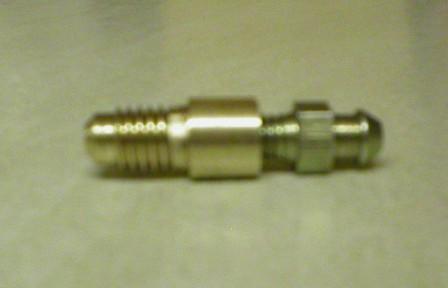

Yes, I have... Pug 205 front calipers were famous for it.. They were made of ally and the nipple steel... Go figure :twisted:
I used to drill them out oversize, retap and make up an adaptor from a bit of brass on the lathe...
One like this:
Can be adapted even to Luton's finest :wink:

CitroJim wrote:Yes, I have... Pug 205 front calipers were famous for it.. They were made of ally and the nipple steel... Go figure :twisted:
One like this:
Jim, in my book that is what is known as a work of art :!: Lovely :)
