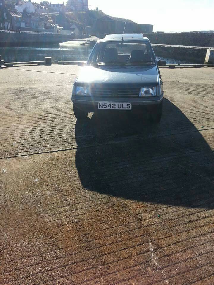

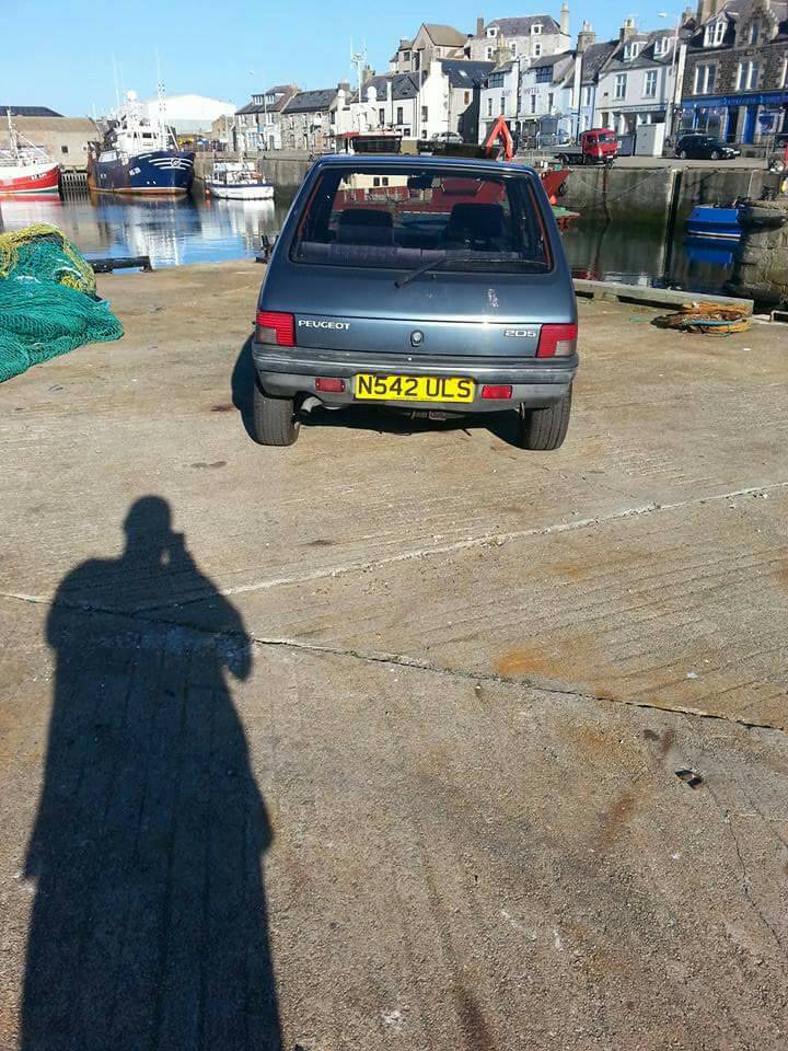

Re: Sloppy gears and high bite in 205
The same age and engine as my 205. I got mine for 100! And it had a bit of mot! It needed a few hundred spent getting passed it's mot a few weeks ago, mostly new brake parts, and a very small patch of welding on the boot floor. My one has o ly done 63000 miles, and drives beautifully. Even with the brakes all renewed at the front the brakes are much heavier than my more modern renault, and the clutch is nearer the top of its travel rather than the bottom. The gear change also isn't the sharpest, but I have no worries about it popping out of gear. It's not as poor as stirring soup. The guys on here are usually pretty knowledgeable but there's not really a lot of 205s on here. Where you will find lots of 205 knowledge is on the 205 owners club on Facebook. They are lovely little cars, great handling and much fun. My son has a gti version, and there's not so much difference as you would think between a 1.1 5 door and a 1.6 gti 3 door. I can have just as much fun in mine than his.

daviemck2006
- Posts: 5035
- Joined: 04 Dec 2010, 18:45
- x 485
Re: RE: Re: Sloppy gears and high bite in 205
Low son ain't good for photos [emoji13]Stickyfinger wrote:that's one hell of a shadow

- Posts: 55151
- x 8422
daviemck2006
- Posts: 5035
- x 485
The ferry from France to Macduff broken and was drifting in the North Sea for ages [emoji12] [emoji13] [emoji23] [emoji23]CitroJim wrote:That's a very late 205
