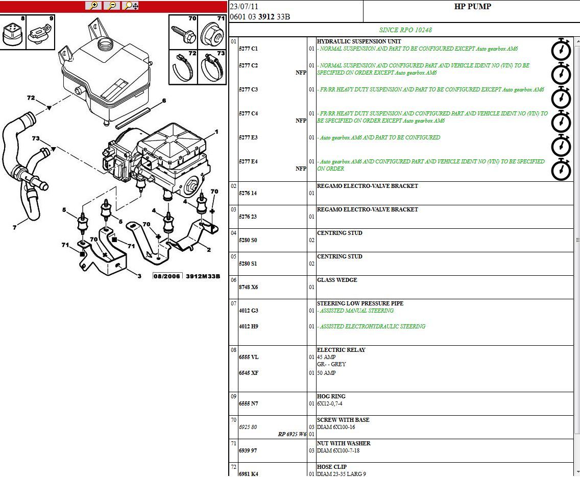

I would do a LHS change urgently if there is dirt in there. eg, tank out and wash the filters etc.
NOTE: Below is NOT based on you Vin number so MAY be incorrect for your car:
