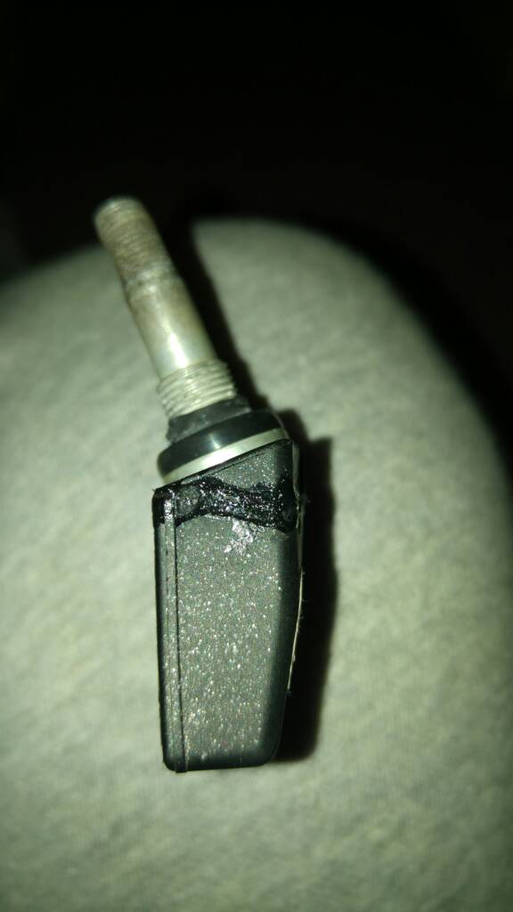

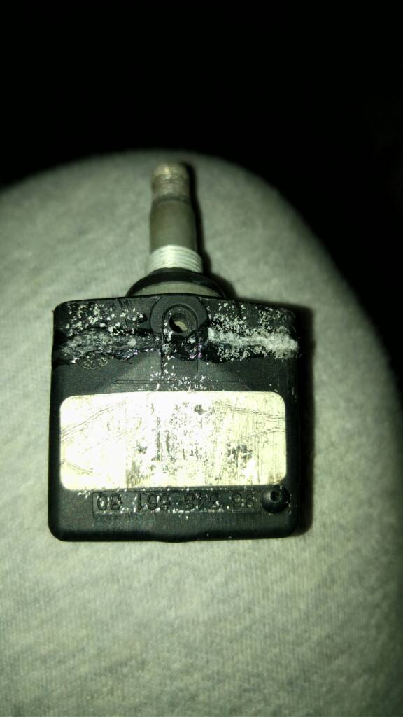

Managed to break my sensor. What is needed in order to fit another sensor either new or second hand?
If I fit a second hand is there any numbers I need from the sensor. Seen a second hand one but the barcode sticker is missing.

I glued it back together…
Seems to be working no faults…
