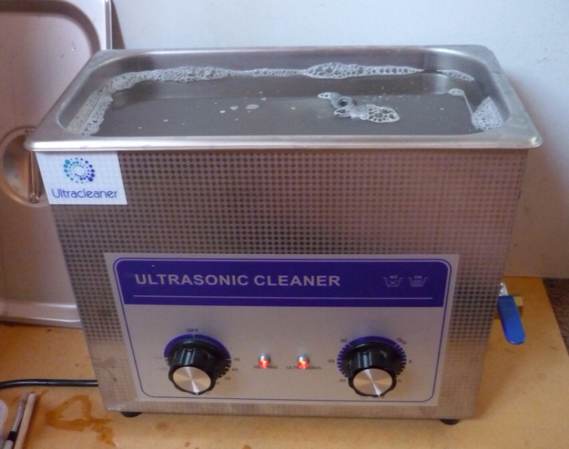

In the end I took the plunge and bought myself an ex-display 6 litre ultrasonic cleaner. I shall be trying it out this week.

Well, I think I'll declare it a success ! I've just finished cleaning a couple of old Kohler 8hp carbs and a Briggs 11hp carb in a filthy condition and the results were quite successful. I did 3 sessions of about 15 minutes each and used a mix of water and APL Chemicals (ultrasonic) engine parts cleaner at 60 degrees. Once rinsed, a quick blast with an airline brought them up pretty good - including removing a lot of the old paint. I took 'before and after' photos, but just imagine a dirty corroded carb, then imagine a clean carb - and you'll get the idea :) The water was filthy at the end !

That's a nice result Bobins :D
