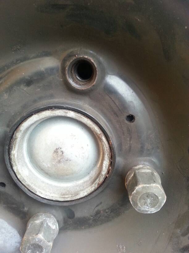

Does the spare look like this
If so you need flat faced wheel bolts. The VTR had them from around 2000, before then they had a taper to them.

The wheel pattern does not look like that you have shown me, this wheel is different. I am struggling with this and I appreciate all your efforts and endeavour, seems I cannot get a photograph to you through this avenue, could you tell me how this is done please .

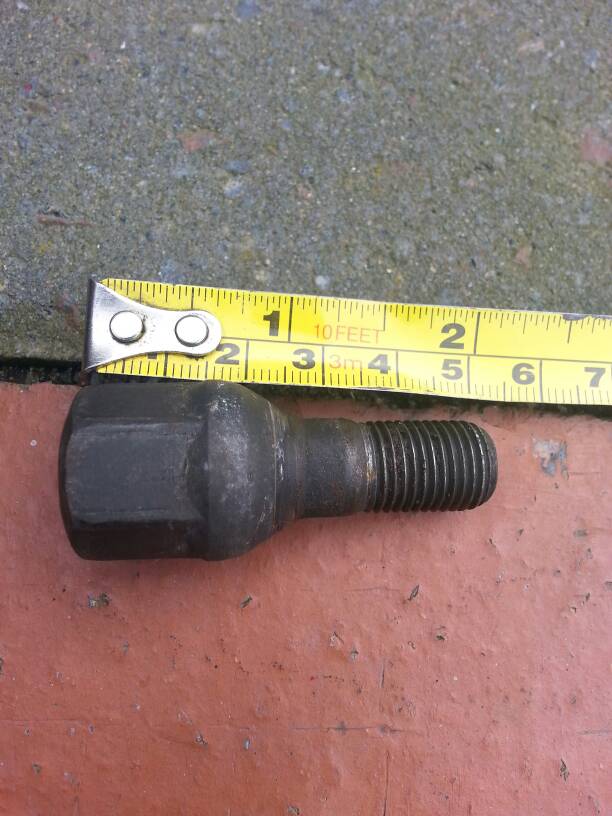

A standard saxo steel wheel will be the exact same as my 205 ones
The standard bolt looks like this
That will be the exact same as virtually every other bolt for a steel wheel on any citroen or peugeot. Your aftermarket ones for your spacers will be 20 mm longer. Go to any scrappy, or mist car accessory shops and you should get 4 suitable bolts to keep with the spare in case you have a puncture again. Hope this helps.

I have put the Mc Gard bolts on, they do not allow the wheel to turn, and probably for the reasons you mention, tell me as one last check what are the size of the tyres on this wheel you have shown me as surely that is indicative of the size of the spare wheel, certainly the spare on here is a different size to smaller engined Saxos, tyre size is 185x55x14, ordinary Saxos surely are not that size. The wheel pattern you show me is the same one as I have that is for sure. Re :Scrapyards, ''throw em away mate'', or '' no Vtr's '' Salvage yards ''what size your looking for'' so in dead stucko compounded by the fact Citroen have three different sizes and not one of their dealerships in the north despite giving the detail and the reg plate knew which bolt fit this wheel . .

The vtr will be alloys and the standard bolts for them will be different to what I have shown, and their tyres will be 185/55x14. Lesser saxo will be steels don't know their size. My 205 is steels standard 165/65x13. The reg number is not what you need, the trouble with dealers is that they hold no stock and order everything by computer and the parts man might not even know what he is ordering. The mac guard bolts you are trying will be extended ones for the spacers for the aftermarket wheels. My local scrappy keeps boxes of various different wheel bolts and sell them at a pound each. Buy the ones which are linked above, they will not do the spacers but are perfect for your steel spare.
If you do try a scrappy again don't ask for vtr bolts, just ask for citroen wheel bolts for steel wheels.

I have the bolts sent by air mail, however, these bolts are not exactly the same as the one shown by daviemck2006 who so kindly sent the picture, head size is correct, total length is,taper is too, but where there is a space [no thread] on it these bolts received have a thread 28mm- 30mm long depending on where one measures from on the thread where the taper ends. Before I fit and dirty the heads, mark them even, is it going to make a difference fitment wise, does anyone know please.Would show these bolts to the audience but I cannot figure out how I send a picture.I think the space in between the thread and head on the correct bolt is there for a reason and that will be so the thread does not go too far into the hub, hence giving the same problem I have now, where those bolts Mc Gard[see previous entries] are fitted, the length which probably goes well into the hub and maybe touches the back plate will not allow the wheel to turn.
