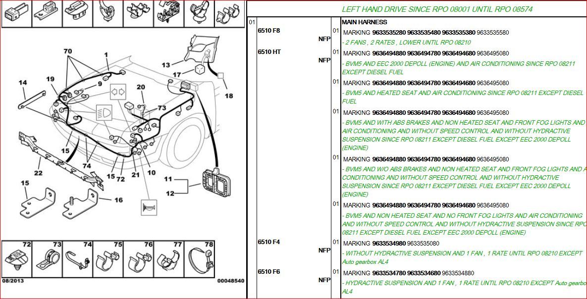

It may be coincidence that this happened after you had the front bumper off, but there's a main wiring loom runs along the underside of the radiator, although I can't immediately understand how this could affect the fuel pump issue.
- Posts: 55111
- x 8406
Re: Xantia hdi cut out , no power at fuel pump
It can Alasdair as that loom carries virtually everything, even the earth for the dashboard clock!!!
It has a number of splices (joints) in it that can fail... They can get damp into them, often from the cooling system, and that corrodes them.
