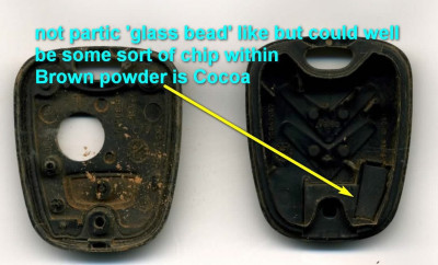

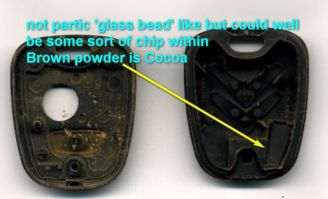

There is an immobiliser chip within the casing somewhere. With some (but not yours, it seems) it is on the main circuit board, while on others it is either in a separate cavity in the fob body, or in a small cavity in the key head (that pivots). Typically it looks like a large glass grain of rice.
The car, when the key is turned, looks for this chip (via an inductance coil) and reads the value. If the immobiliser electronics in the car recognise that chip they will allow the car to start, otherwise it is no-go.

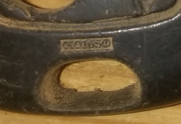

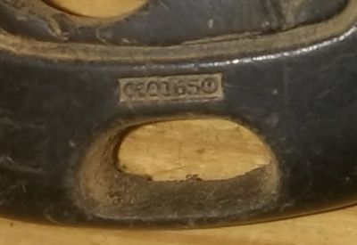

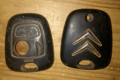

Thanks James, after rooting through the kitchen bin, it looks to me like its here (see pic). Unfortunately, it seems SWMBO had thrown away a load of Cocoa Powder.
I think the linked page procedure I found could probably be described as a re-synchronisation procedure, Marc and hopefully the visit to a Citroen Dealer won't be necessary....
...particularly if I can get hold of half a genuine Citroen key of that vintage.
I'm thinking that the way to go is to replace the 'Button' side of the key only, thus retaining the Transponder, but gaining working Plip Buttons.
Anyone got a similar vintage of PSA Key with good Buttons that they're happy to pass on for a few squid? Only the Button side required. (not the PCB, Chip or Key Shaft; but a complete one is fine too) CE0365?
I know that half the new Fob is different enough by a 1mm or two that it won't fit the old key as we tried that pretty much straight away; daughter stating a preference to keep the original Citroen Logo.
