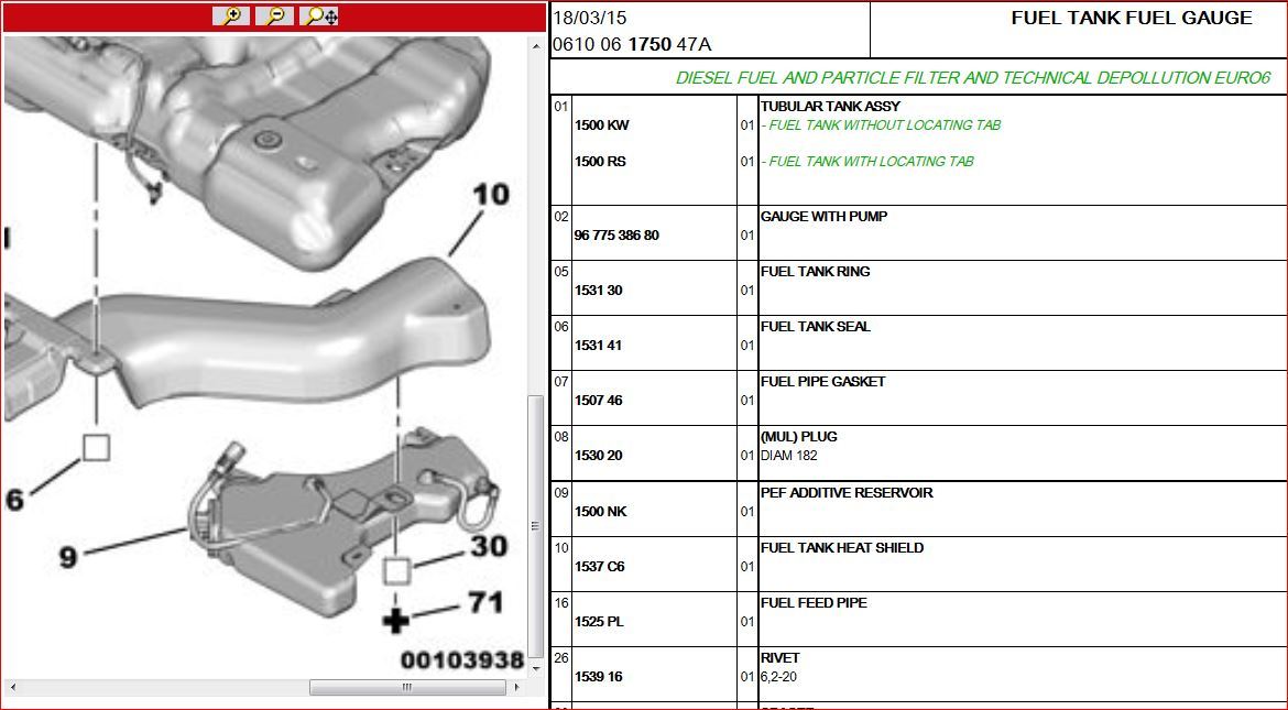

Where is the window you mention situated?DickieG wrote:How many miles has the car done? The tank level can be viewed via a window on the side of the tank so it might well be half full but if/when it has been topped up the ECU wasn't reset at the same time than as Sticky says the ECU will assume that the tank is now empty.
I have the under shield partly detached but can't find the window.

Thanks for this Sticky, but I still cannot see a window on the PEF reservoir to check the fluid level.
Am I being blind and stupid?

The window is where number 9 on the parts diagram is pointing which is this white plastic plate through which you can view the fluid level.

nice pics Dicky
they look like this off the car
nice pics Dicky
