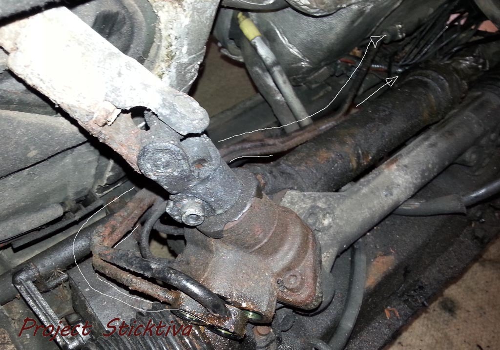

Anyone got a pic of UJ so i know what to aim at with Plusgas [emoji1]

Thanks for that sticky ... so which bit gets doused with plusgas/grease, all of it or just that upper section with the swivel on it?

Posts: 11837
Joined: 28 Mar 2013, 21:05
x 1995
Re: Steering gear stiff.
Unread post by Stickyfinger »
I hit the UJ on the top, the pinion should be ok if the seal is secure. My present one is clean as a whistling thing. I got it when it was up on the ramps in the garage with the liner off.
