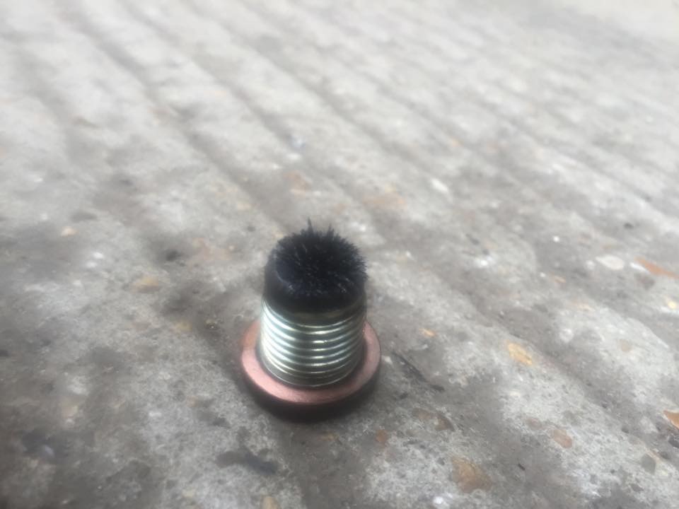

all other gears are ok in that they can be engaged and driven , the box was not dropped , maybe a bit rough handling when fitting. and yes the gearbox locks as if in forward and reverse gear abruptly stalling the engine , is it worth stripping the box to repair , or will it happen again ? ps on draining the oil from the box the oil was almost black and there was a couple of gramms of swarf on the magnet , will attach a picture later today if i can,
