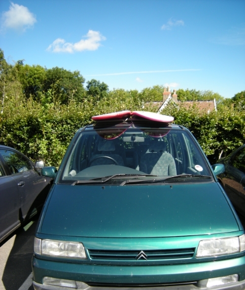

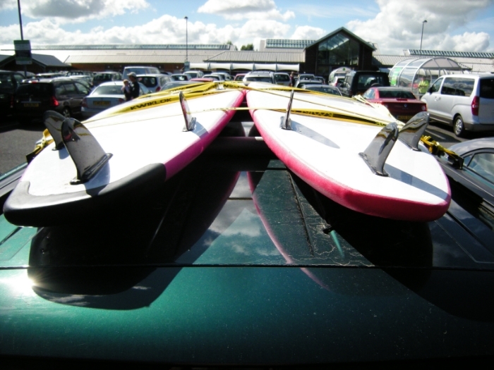

I cut 4 short angle sections, each about 4" * 1.25" of 1/8" aluminium, with an M6 hole drilled on one side and a slot on the other. Mark on the roof the position of the holes you want to use, slide the cover strips back in and drill it in the right places. To fit the angle pieces, I used stainless M6 allen set screws with a spring washer.
(if you want to remove the angle pieces later you can just put black blanking plugs in the holes, nobody will think you have desecrated a Synergie - I painted them black and leave them in place).
You can also fit a roof rack, drill the foot of an old one and fit with the 6mm set screw and you have transverse bars. Common sense will tell you if its secure.
I mainly use it to carry surfboards*, a bungee across the roof with a section of cheap foam rubber pipe insulation around it, 2 boards on top, then strap down with luggage straps. OK for ladders too. See photo, look to right hand side to see the bit fitted to car.Image , Image
(*an aside, if you take the middle seat out of row 2 and no row 3, the armrests pop out easily and you can take 2 surfboards or a large stepladder inside, on edge up the middle of the van)
