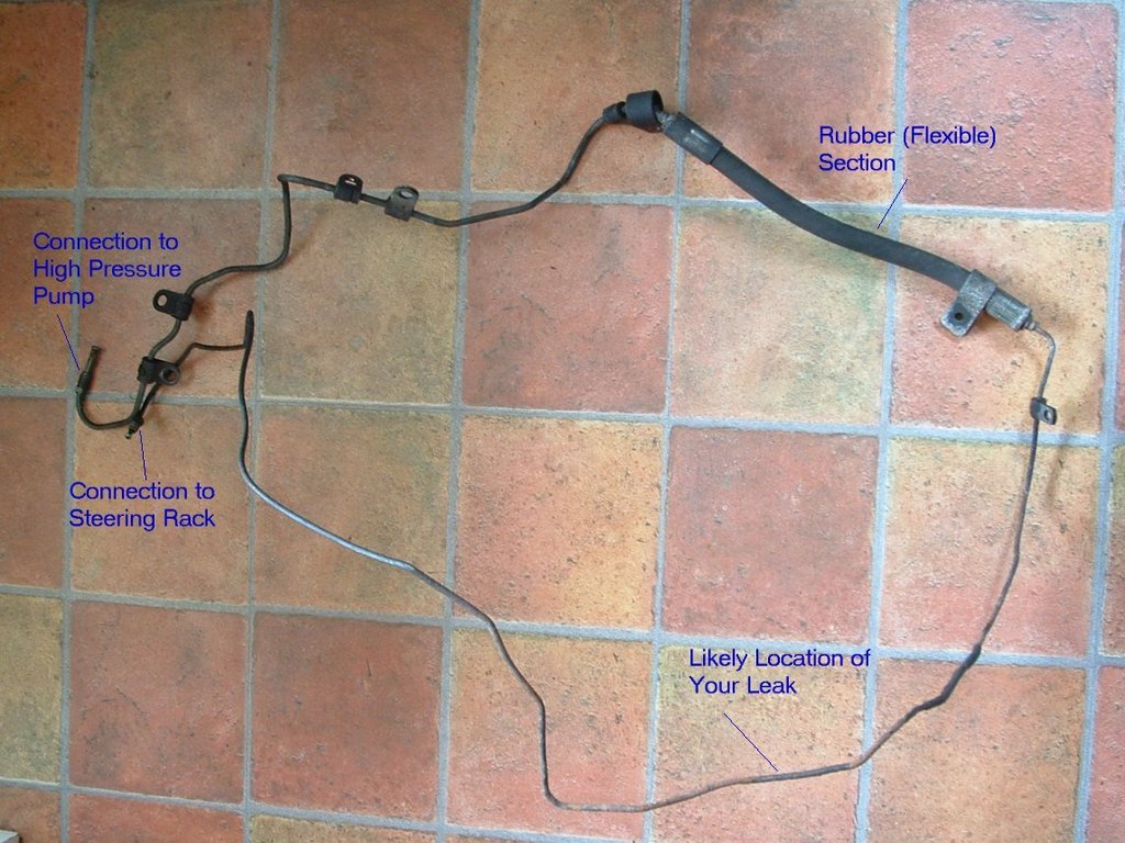

This is the power steering supply pipe that I think is what is leaking on your car.

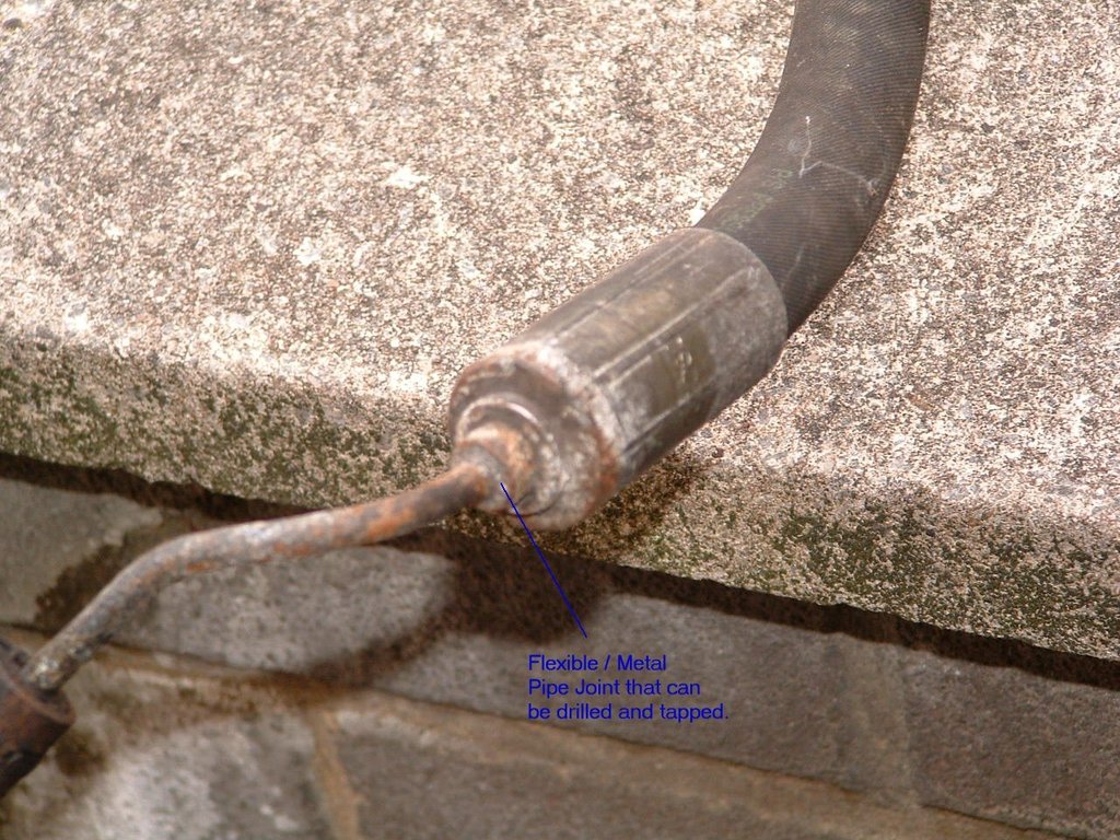

This is the where the metal pipe is joined to the rubber pipe as mentioned by Lighty above.

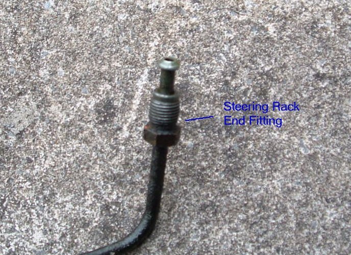

This is the end of the pipe that connects to the steering rack
Getting the pipe on and off the car is not as bad as it looks.

It depends on how corroded your pipe is and where. I had one fail where the metal pipe goes into the flexible one (as per photo above) and the pipe in the photo was changed because it was picked up by the MOT man as corroded in the same place as yours. The MOT man thought it was a brake pipe and as there was a fail for some welding as well I decided not to argue and just change it. In the end the rust is not that bad, just needs a clean up and paint hence why I have kept it.
Anyway back to the point in hand. If it is only the middle section that is corroded and the pipe into the flexy is OK one of these hydraulic pipe repair places might be able to sort out a repair, whether they can/ are prepared to do it with the pipe on the car is another matter. If the bad bit can be cut out and the ends on the pipe flared then a new piece of pipe can be let in.
