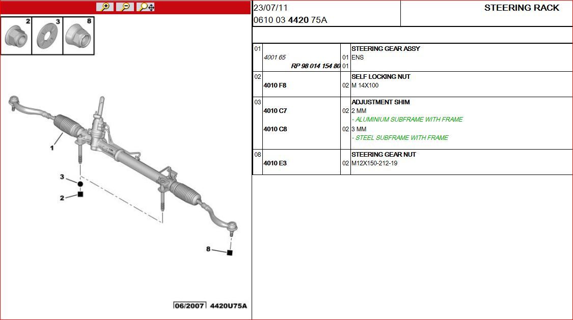

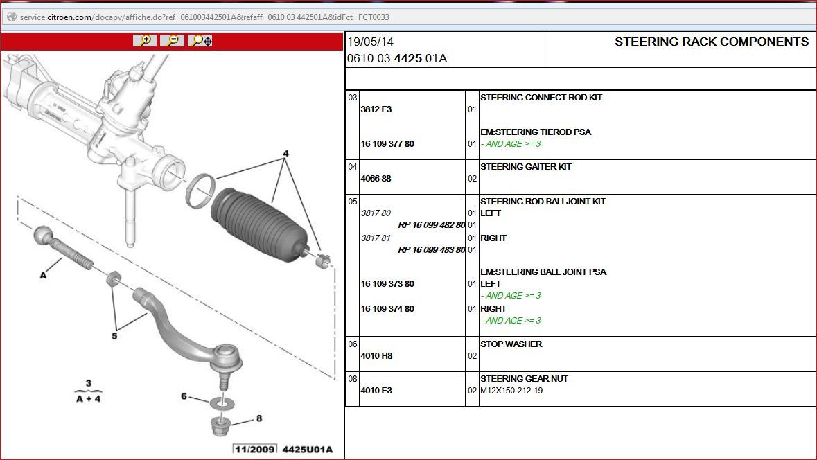

- Posts: 11818
- Joined: 28 Mar 2013, 21:05
- x 1998
Mikep511
- Posts: 17
- Joined: 20 Feb 2013, 19:41
Re: Recon Steering Rack C5 2008 onwards
Thanks very much for the drawing - very helpful indeed !!
Just one final question - what do I actually need to order (crossed fingers for a recon option!!) I assume it is all the parts shown in the top drawing and are the part numbers the ones in the left hand box next to each part ie steering gear assy number 4001 65 Also any difference in the part nos if it for left or right hand drive - sorry to be asking so much questions but just want to make sure I order the correct parts.
Thanks again
Mike p
Thanks again
Mike p
